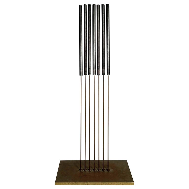

    We happened to watch Antiques Roadshow last night, where a woman brought a piece of metal sculpture by Harry Bertoia, an Italian artist of mid-20th century.  The sculpture was of about a dozen standing rods of beryllium copper, each about 1/4″  in diameter for the first 3 feet, then maybe 1/2″ diameter for the top ends about 12-18″ long (dimensions estimated from memory).  Think cattails.  What was impressive was the obvious precision in that the rods seemed closely spaced and perfectly aligned – this after maybe 50 years or more.   I started life with a decided bent toward the artist side, so I have more than a little appreciation for the beauty of this piece.  Bertoia tried to include sound in his works, and this was as musical as a wind chime when you brushed your hand across the rods, as you would a guitar.   He also published an album “Somnambient,” using the musical sound of his various sculptures.  He apparently used beryllium copper in quite a few of his works and died at 63 in 1978 of lung cancer.  Go figure.
    The appraiser estimated value as between $80,000 and $120,000.  The one I found below is a smaller version for sale at $60,000.
    Midcentury Harry Bertoia Sonambient Sculpture For Sale
