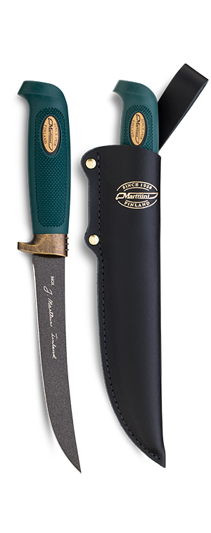

    This is one area of the WE (Gen 3 Pro) sharpening that I’m trying to learn at the moment. How to tighten the blades to the vise so that they don’t move during the sharpening and not overly tighten to leave marks. It is especially challenging for me with the Marttiini hunter’s carving knife and other knifes with the similar coating. “Martef coating reduces friction to almost zero”. This is a nice feature until sharpening is concerned 😀 I have experienced with blue masking tape, real leather chamois etc. They might stay in place easier when re-profiling is not needed and I might try to use my low angle adapter to get better grip from the carving knife.
    My other hunting knife (Big Game Martef) is also Martef coated but the blade feels a bit too thick to use with my leather chamois. It should only be 0.11″ thick blade so without the chamois it is Ok but it is challenging to attach to the vise so that it does not move and the coating stays undamaged. I have used this knife heavily for the past 10+ years so the blade is not new but I would still prefer not to damage it during the sharpening. This is a learning process for sure.
    Picture: Marttiini hunter’s carving knife from marttiini.fi

    I regularly use real leather chamois between the knife blade and the vise jaws.  I cut a small rectangular patch that I wrap up around the knife sides to protect the blade when clamped in the jaws.  Sometimes once the knife is positioned and clamped securely, I will need to trim off excess chamois cloth that hangs out the top of the jaws and hangs over the sides with a small scissors.
    Jay before you assume you’ll need to use the low angle adapter, LAA, try to clamp this knife in the jaws as high up as you can while still allowing you to clamp the knife fully, tightly and securely.   The knife may need to be raised higher above the depth key pins, where it no longer sits on the pins, to accomplish this.  As long as the knife is securely clamped is all that is important.  You can still employ the alignment guide, AG, or the advanced alignment guide, AAG, using the depth pin to record this clamping position in your sharpening log.
    Only after you determine that this high position clamped knife can not be sharpened due to stone – vise contact if the set bevel angle is low, would I opt for the LAA or the Tormek small knife adapter.  I attempt to use the Gen 3 Pro jaws first, always.  I found I can make it work more often then expected.
