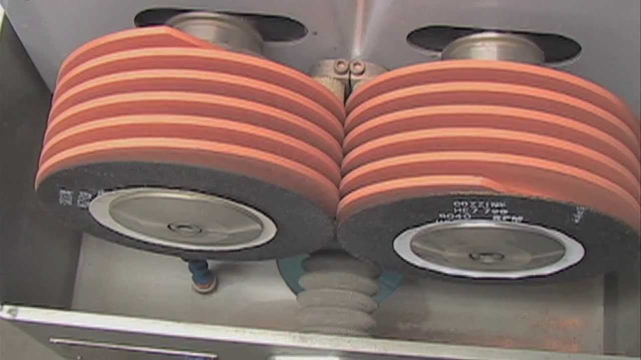

Perhaps these are included angles of a secondary bevel upon which a small or micro apex bevel is formed? That would make sense for machine sharpened knives I think, as in videos I’ve seen there is usually a edge grinding operation, then final sharpening is done separately.
By edge grinding I mean things like this, but not always hollow.
