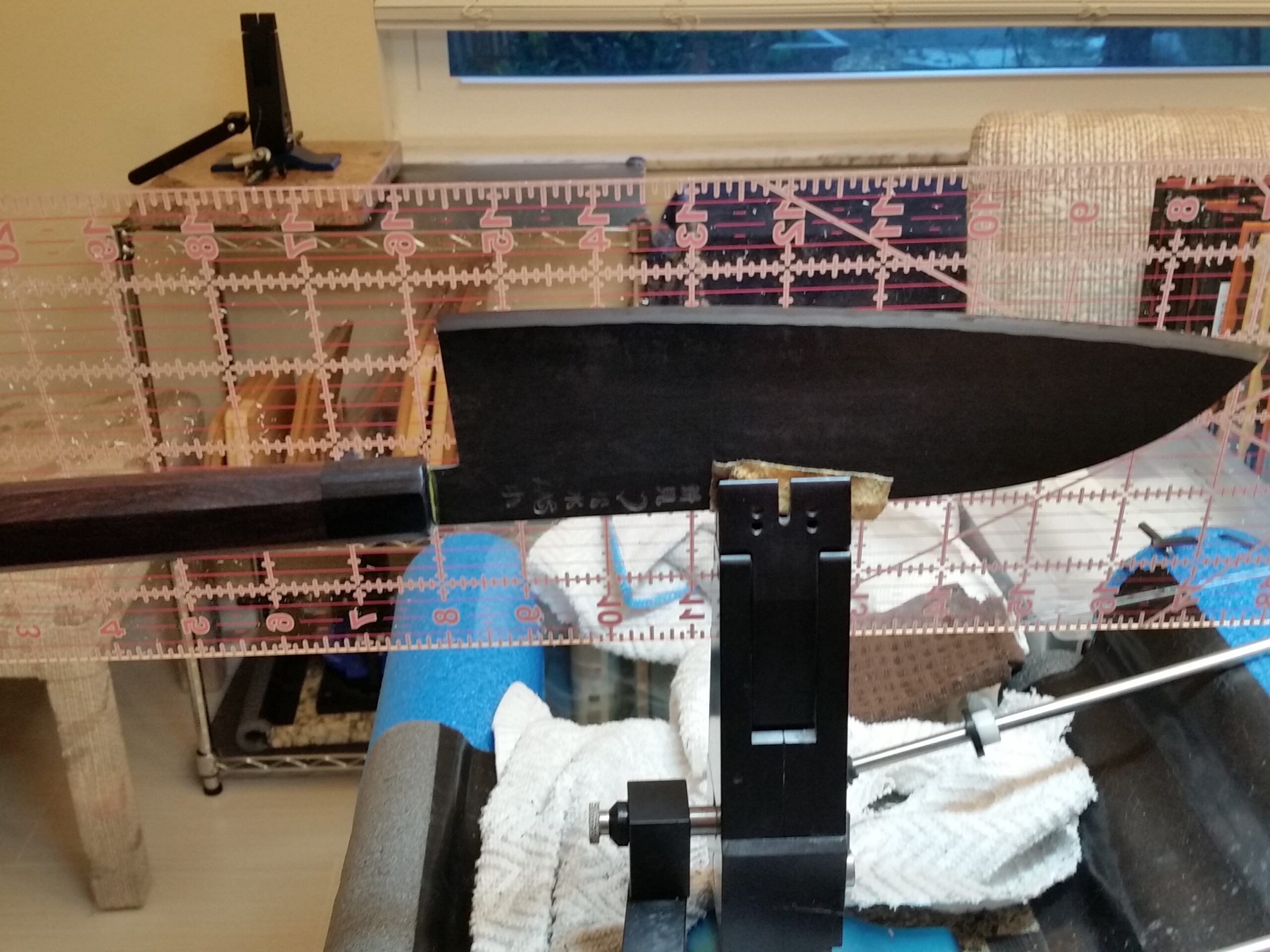

You get creative and make something like this:
Like I wrote: Many of us modify and custom adapt our sharpeners well accessorized models to enhance their sharpening abilities and characteristics.
Thanks for the insight Marc - those are the kind of tips I was looking for. Not sure the first couple posts were worth it :slight_smile:

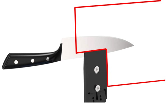

The majority of the knives I have sharpened on my WE130 required the use of the LAA. My solution to this problem was to not use the Depth Key and to align the AAG as shown in the image below. It has worked extremely well for me over the last three years.
rummels
That will work good enough to record the position. I might be able to balance it on there long enough to take a photo of it.
Because you are using a LAA, you can tighten its jaws just enough to hold the knife in place. Then position the AAG as I suggested, and move the knife forward or backward in the LAA until it is where you want it. This assumes you are protecting your blade with masking tape.
rummels
