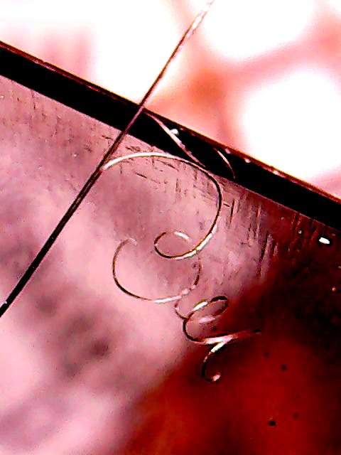

As far as a practical, easy to do test for sharpness, to determine a level of refinement in the apex of a secondary bevel? I still like the whittling hair test…just dont pull it out of your wifes head(she seems to not like that so much!)
Kitchen knife I was doing some testing on tonight. Im happy with the results of new technique!
I do use my girlfriend’s hair . It’s much thicker than mine.
