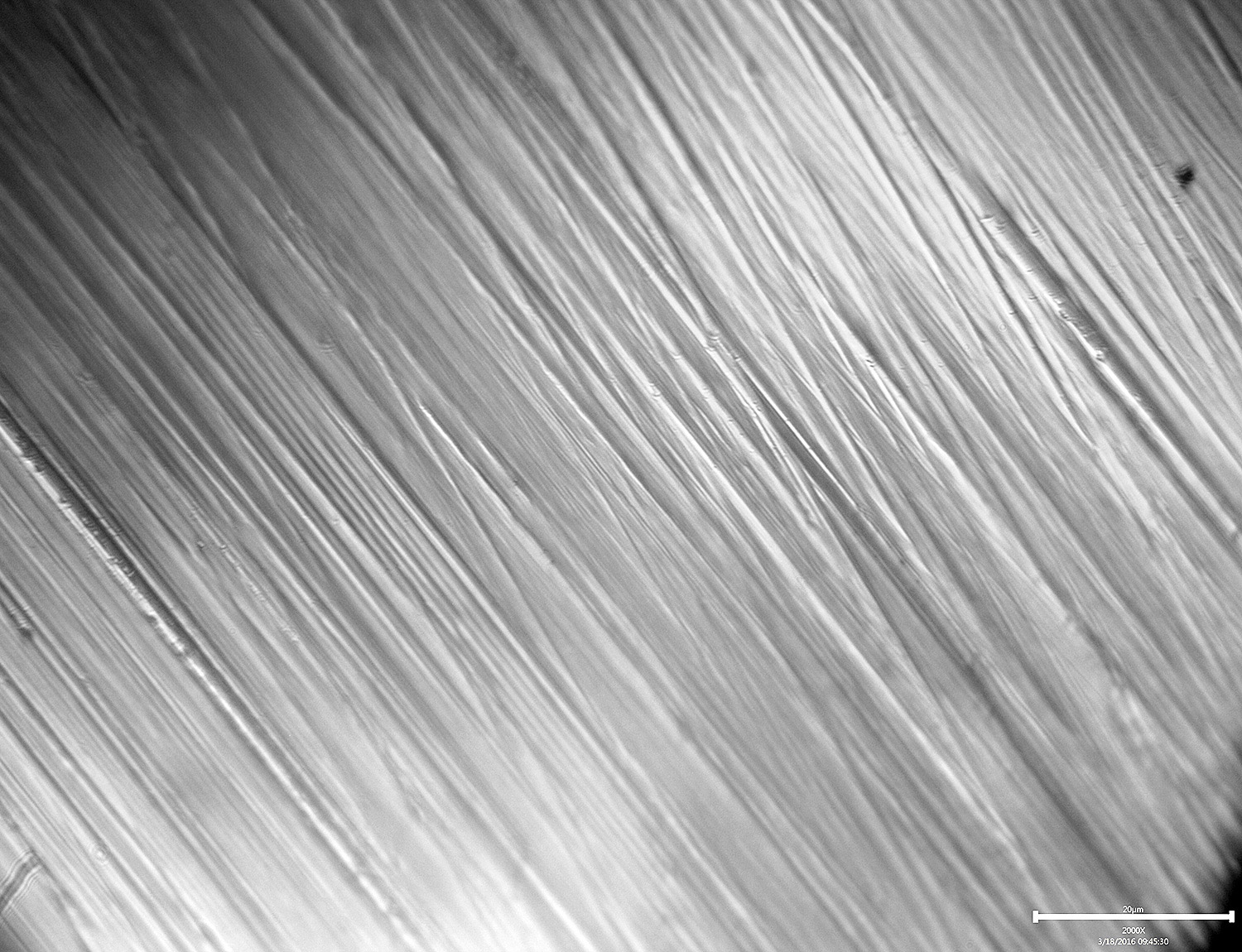

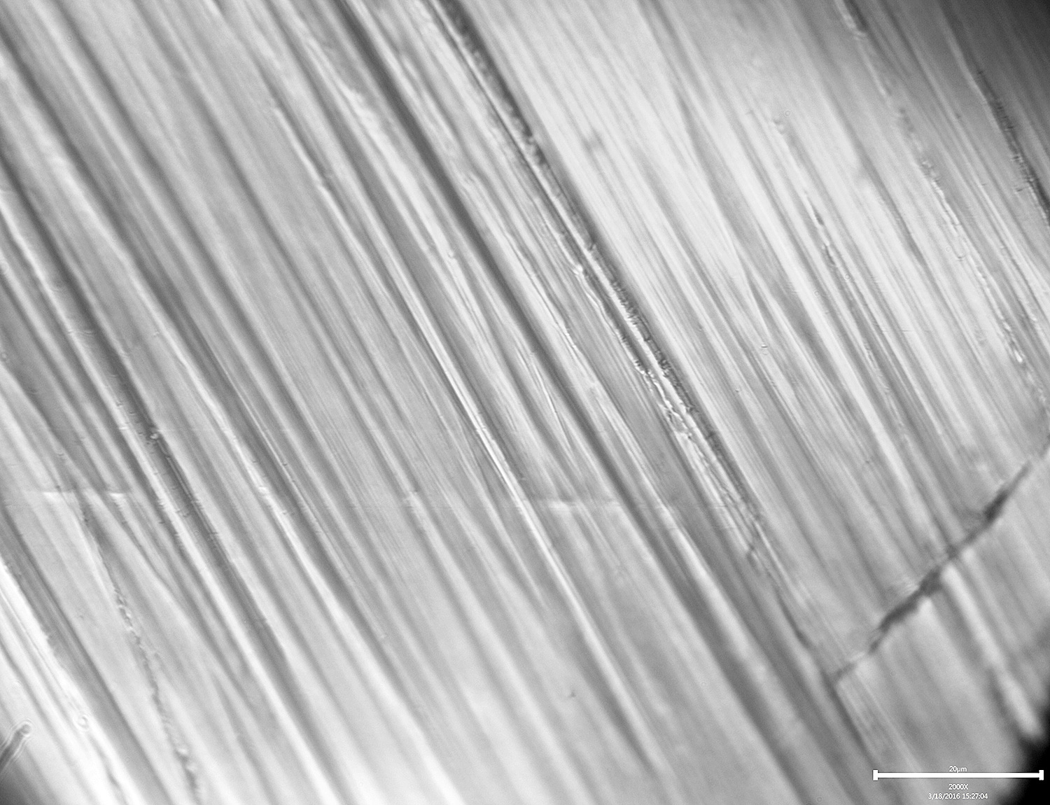

I put the bevel pictures in order so I could compare the scratches.
1000 grit:
1000-Bevel-Trailing-A
SFC:
SFC-Bevel-Leading-A
SFF:
SFF-Bevel-Leading-A
MFC:
MFC-Bevel-Leading-A
MFF:
MFF-Bevel-Leading-A
I think this is the preferred order, but I’m still hesitating on some transitions. (Like MFC->MFF. On the other pics I was convinced the MFF were the finest stones, but here there scratches look wider, although maybe a bit shallower, than those of the MFC.) Curious what other people think.
And here are the final bevels of two progressions to compare:. May we have your votes, please?
1000->MFC->SFC->SFF-MFF:
MFF-Bevel-B
1000->SFC->SFF->MFC->MFF:
MFF-Bevel-Leading-A

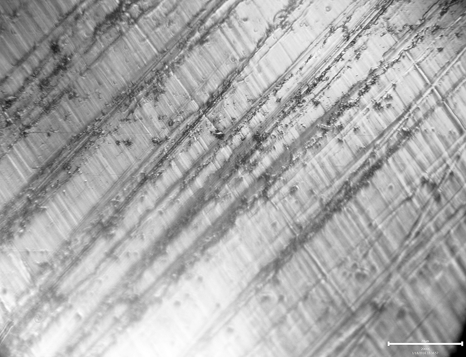

Some good points raised here. I decided to try what was suggested and check the efficiency of each of the stones at removing the scratches of the 1000# diamonds. So first I did 20 strokes with the diamonds:
[attachment file=“1000#-A.jpg”]
Then 50 strokes with the SFC:
Then another 20 strokes with the 1000# diamonds to erase the SFC scratches. I didn’t image that but was very confident under the loupe that the diamond stones remade the bevel.
Next up were 50 strokes with the SFF:
I remade the bevel again with another 20 strokes with the 1000# diamonds and then did 50 strokes with the MFC:
Remade the bevel again and then 50 strokes with the MFF:
And for fun, remade the bevel again and then 50 strokes with the 6µ Diamond Lapping Films:
The lapping films were already well used, definitely not new strips.
Probably the best, or at least the most telling tests done on this subject so far.
Good experiment design is everything I guess :slight_smile: Credit to dulledge for the suggestion, thanks!
At each iteration, the scratches going top right to bottom left (TRBL) were renewed with the 1000# stones. Any scratches going from top left to bottom right (TLBR) are from the stone listed and any remaining scratches in the TRBL orientation were 1000# scratches that the subject stone failed to remove.

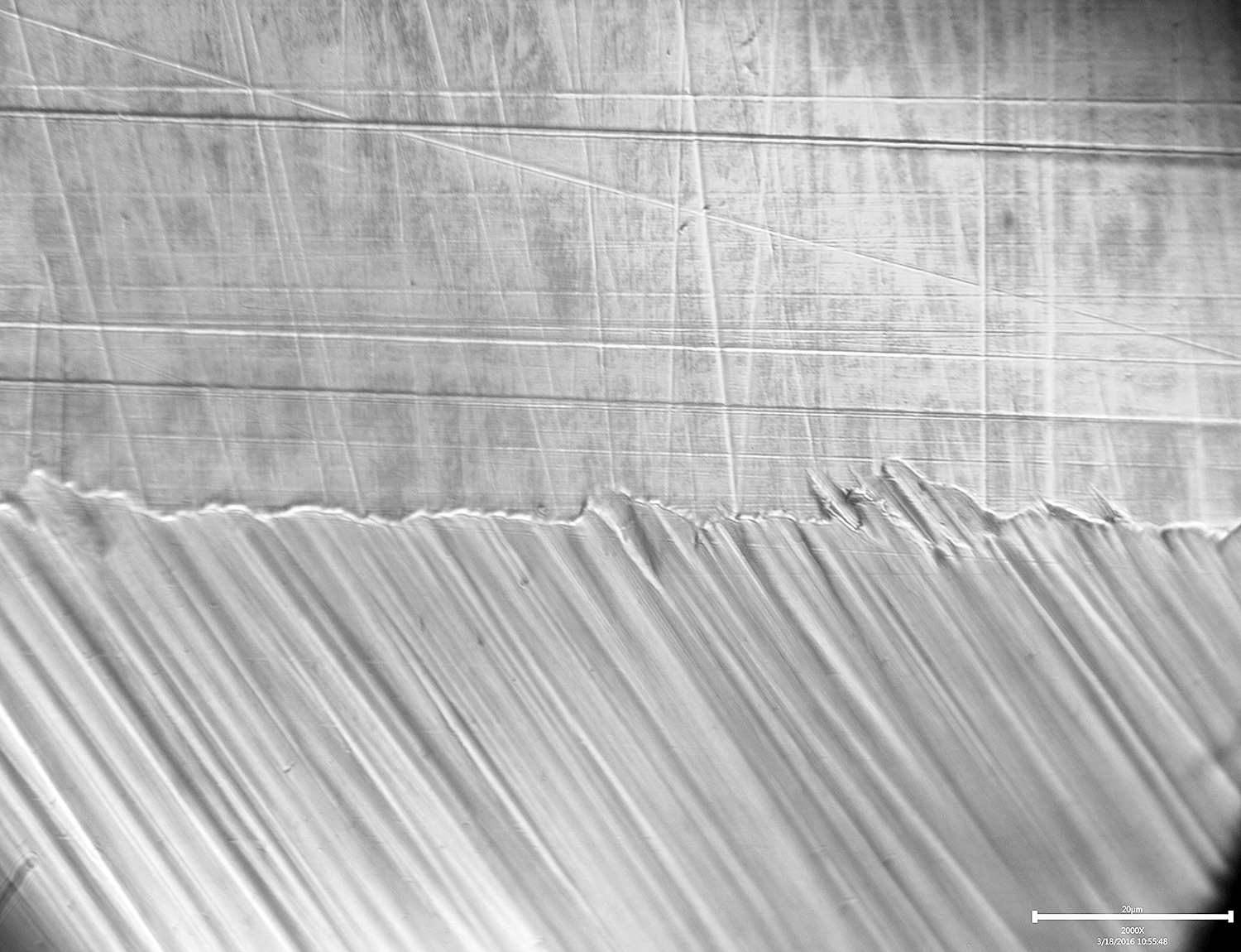

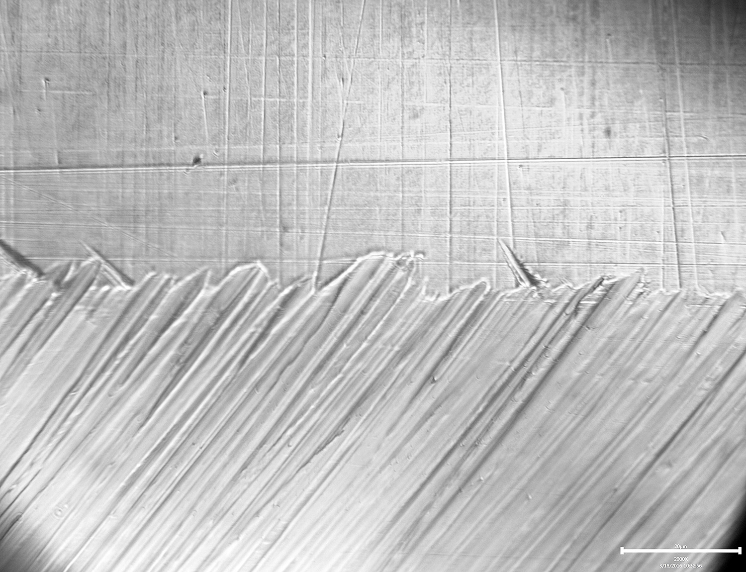

I did 20 edge leading strokes with the 800# diamonds:
[attachment file=“800#-Bevel—A.jpg”]
[attachment file=“800#-Edge—A.jpg”]
And then set to erasing the 800# scratches with the 1000# stones, checking every 5 strokes to see if any scratches remained. Most were gone after the first 5 strokes but it took a full 20 strokes for them to be all erased:
[attachment file=“800#-1000#-Bevel.jpg”]
[attachment file=“800#-1000# Edge.jpg”]
