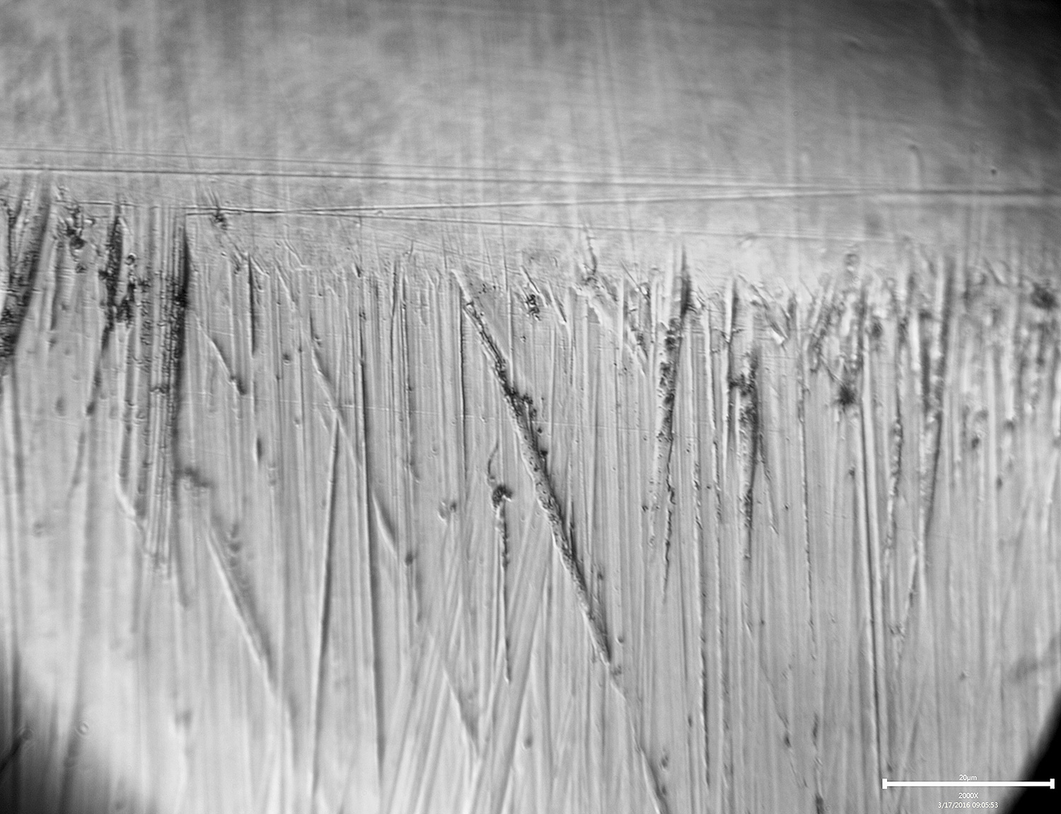

Okay, I did the last progression: 1000#> SFC> SFF> MFC> MFF:
For some reason I was struggling to make nice, smooth and straight strokes this morning and the more I tried to focus on it, the worse it got . So, the scratch pattern is pretty crazy but I think the photos still show enough to be useful. I didn’t take photos at every change of grit because we already know what they look like and it takes a long time to image each grit.

Hmmmm… So here’s the last step side by side…
To me, the left side looks smoother…
Judges? ?
That’s pretty fascinating Curtis. I’ll have to try a couple more times to make sure it’s not user error…
My new theory is… yeah, I really don’t have one.
To be fair, while the left side looks smoother overall, the right seems to have a finer scratch pattern.

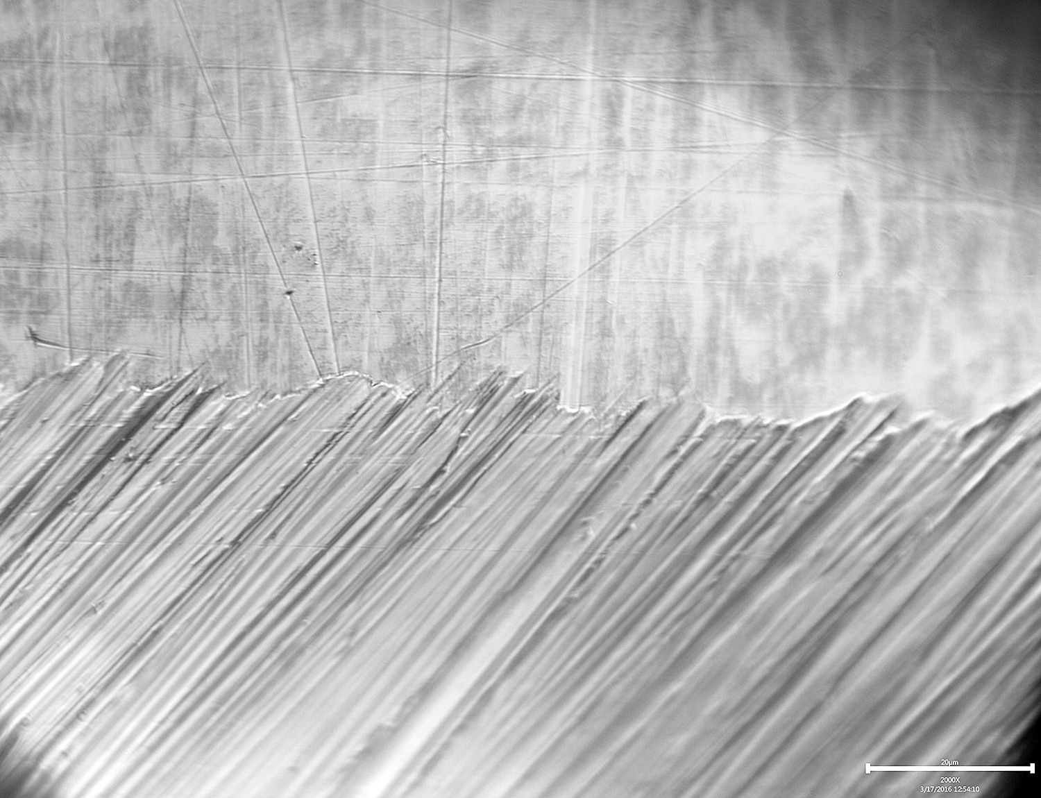

So close it’s hard to tell. So I tried a 420HC knife, doing one side with just the MicroFines, the other with just the SuperFines (both after the 1K diamond). Then polished with a 5K and 3.5K leather, (both freshly ‘charged’).
They’re so close, it would be almost impossible to tell them apart. They’re both not quite a mirror… you can see a reflection, but you can also see some light scratches in both.
I’m pretty sure, from past experience, (didn’t try today), that using all 4 produces a better result, even better than just using one set twice as long. So maybe each set does something different that contributes something to the overall result? But by themselves, I’m beginning to think that it may not be different enough to matter?

I was curious because in the pictures of the blades in the Bladeforums post I referenced… eKretz (the guy taking the pictures) shows little holes where he says the Vanadium? is being pulled out of the metal. I noticed something similar in your pictures, where it looks like something is being pulled out, and then scratches down the blade. Wondered what it could be.
[quote quote=32148]
Clay… Just outta curiosity, what type of blade steel is that in your pics?
Unspecified “high carbon” steel, a.k.a. utility blade, Fat Max brand.
I was curious because in the pictures of the blades in the Bladeforums post I referenced… eKretz (the guy taking the pictures) shows little holes where he says the Vanadium? is being pulled out of the metal. I noticed something similar in your pictures, where it looks like something is being pulled out, and then scratches down the blade. Wondered what it could be. [/quote]
I think Phil Pasteur and Anthony Yan also made the same comment on my photos a while back. It looks like some kind of particle or grain is ripped out and then dragged across the surface. I notice it most with the strops, especially once I’ve gotten the surface very smooth and I’m using the kangaroo strops with a fine spray.
Here is the new set with the following progression: 1000#> SFC> SFF> MFC> MFF utilizing a crosshatch pattern to ensure that the previous scratches were completely removed.
[attachment file=“1000#-Shoulder-Trailing—A.jpg”]
[attachment file=“1000#-Bevel-Trailing—A.jpg”]
[attachment file=“1000#-Trailing—A.jpg”]
