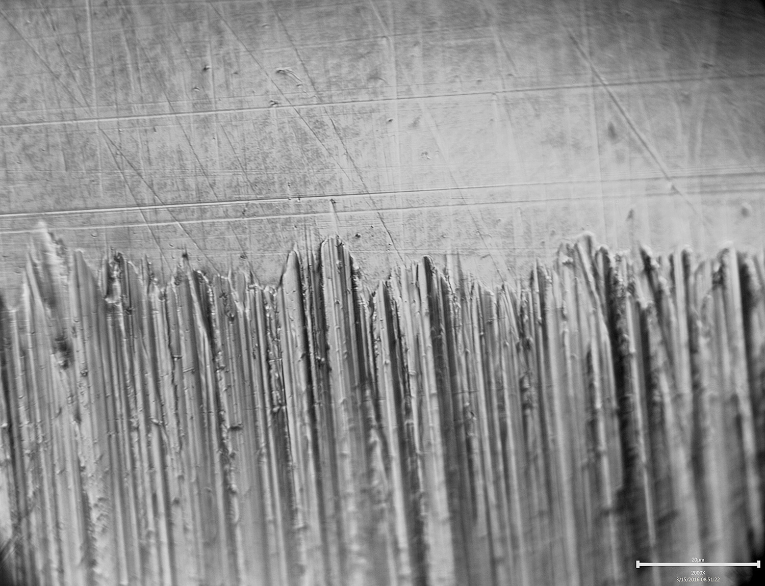

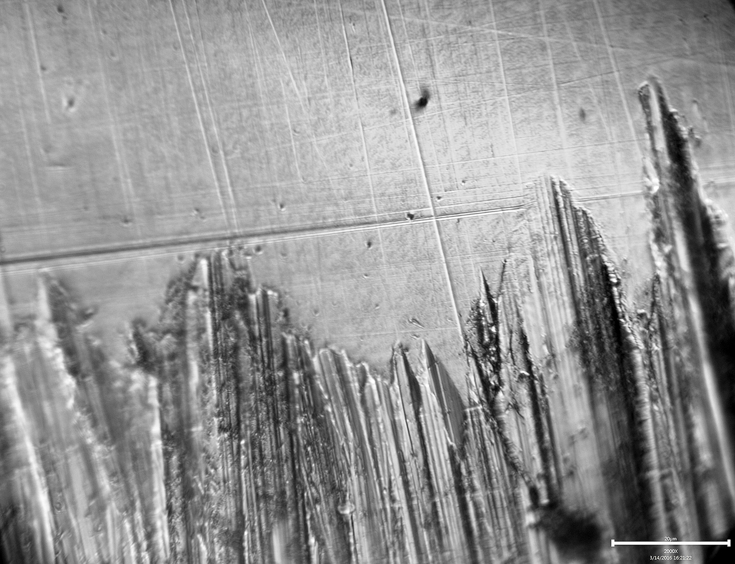

Wow, particularly the microfine coarse stones are a huge surprise to me! In my experience they were a lot more coarse. I have to repeat my experiments. I’m also interested what other people’s experiences are. (Unfortunately we don’t have such nice USB-microscopes as you, Clay.)
I also did the 3µ stones:
The edge is obviously rough showing how there are clumps of diamonds creating larger gouges.

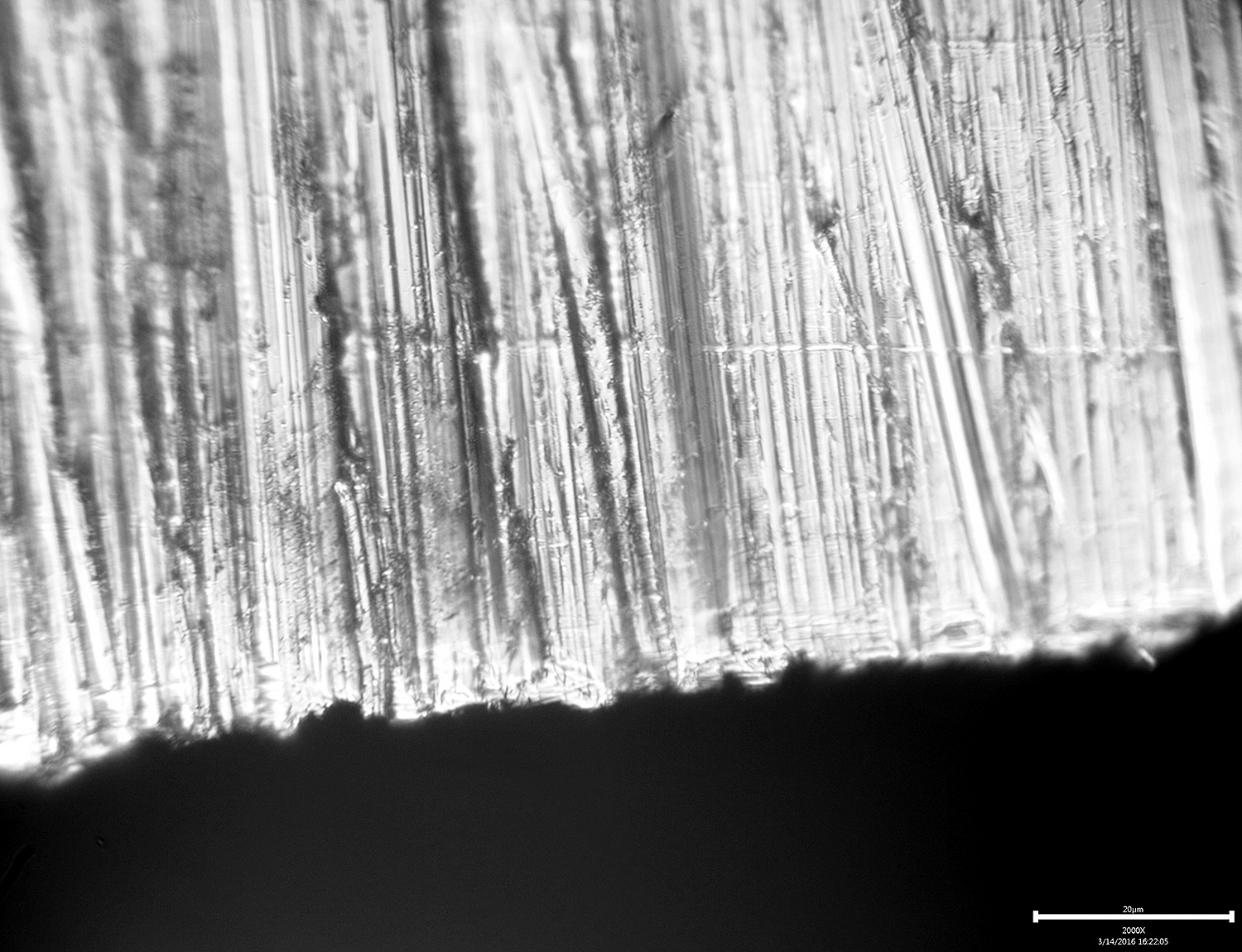

So I lapped the 3µ on my Micro-Fine Fine stones and redid the micro-bevel:
That seemed to make a pretty good improvement. I could feel and hear the difference right away when using the stones.
I think the scratches at the .1 micron film are from two things; 1) a few remaining scratches that I hadn’t removed 2) some contamination on my films. I haven’t been operating in a pristine environment, so some grit is probably getting onto the stones and films.

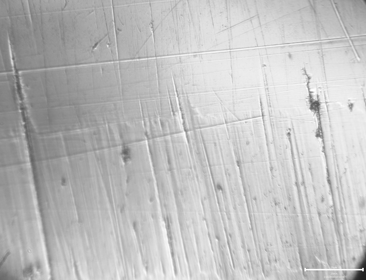

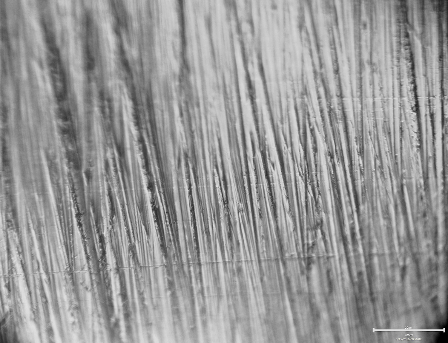

Okay, here’s the first batch, the rest I’ll have to get to on Wednesday:
1000#
[attachment file=“1000#-Shoulder-A.jpg”]
[attachment file=“1000#-Bevel-A.jpg”]
[attachment file=“1000#-Edge-A.jpg”]

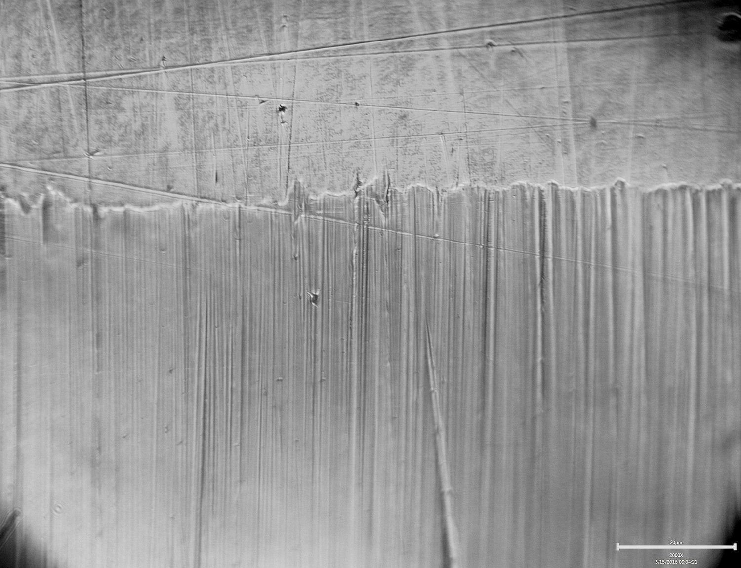

Next the Micro-Fine Coarse:

I put the four bevel pictures next to each other just for myself to be able to compare them better.
1000 diamond:
1000-Bevel-A
Microfine coarse (“1.4 mu”)
MFC-Bevel-A

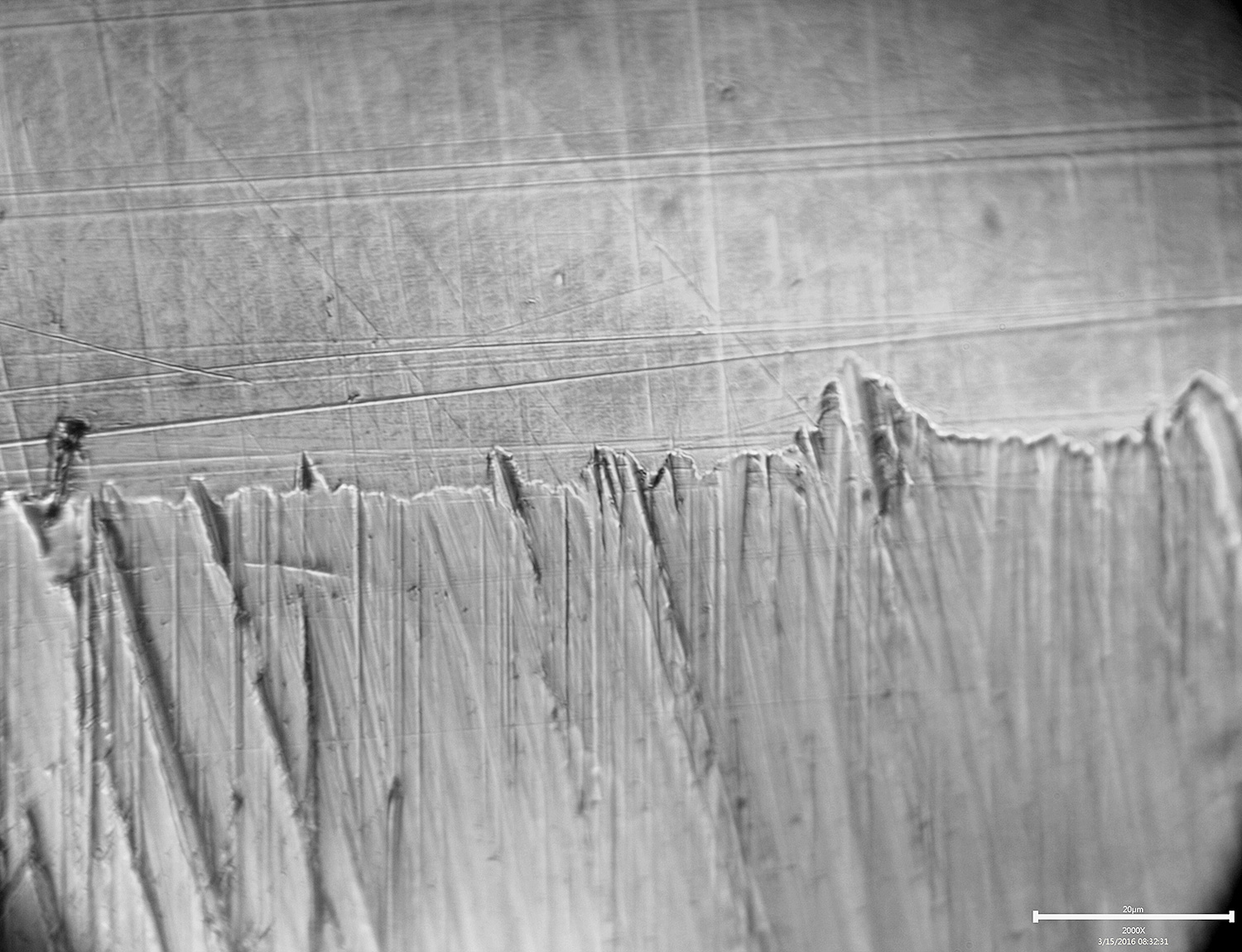

Superfine coarse (“1200 grit”):
SFC-Bevel-A
Superfine fine (“1600 grit”):
SFF-Bevel-A
Microfine fine (“0.6 mu”):
MFF-Bevel-A
This experiment is pretty revealing to me halfway already. What strikes me is that the microfine coarse is much finer than I expected. And what also catches my eye is that most of the ceramic stones seem pretty effective: only in the pic of the MFC after the 1000 grit diamonds (part of my personal progression ) there are very obvious scratches from the previous stone left behind.
Any idea of how many strokes you did with the stones, Clay? And whether there is much individual variation within these stones?
After setting the bevel with the 1000# stones I did twenty strokes per side with each of the subsequent stones. I think the stones are pretty consistent. The biggest variability probably comes from how much a stone has been used and whether it’s been lapped. How it’s been cleaned probably matters as well as how clean it is at the time of sharpening. I imagine that if the stone is heavily loaded with metal filings, it probably cuts much less effectively. Both my MF and SF stones had been lightly lapped on the 3µ diamond stones.
I am newbie without any experience at all, but to my eye it looks like MFC could be skipped in this progression or better used as 1000 > SFC > SFF > MFC > MFF. Am I only one seeing like that? I am very curious to see what Josh is using: 1000 > 30 um film > 15 um film > 9 um film.
Pictures from cbx34 with progression 1K diamond (coarse MF –> both SuperFines –> Fine MicroFine) look very convincing too.
