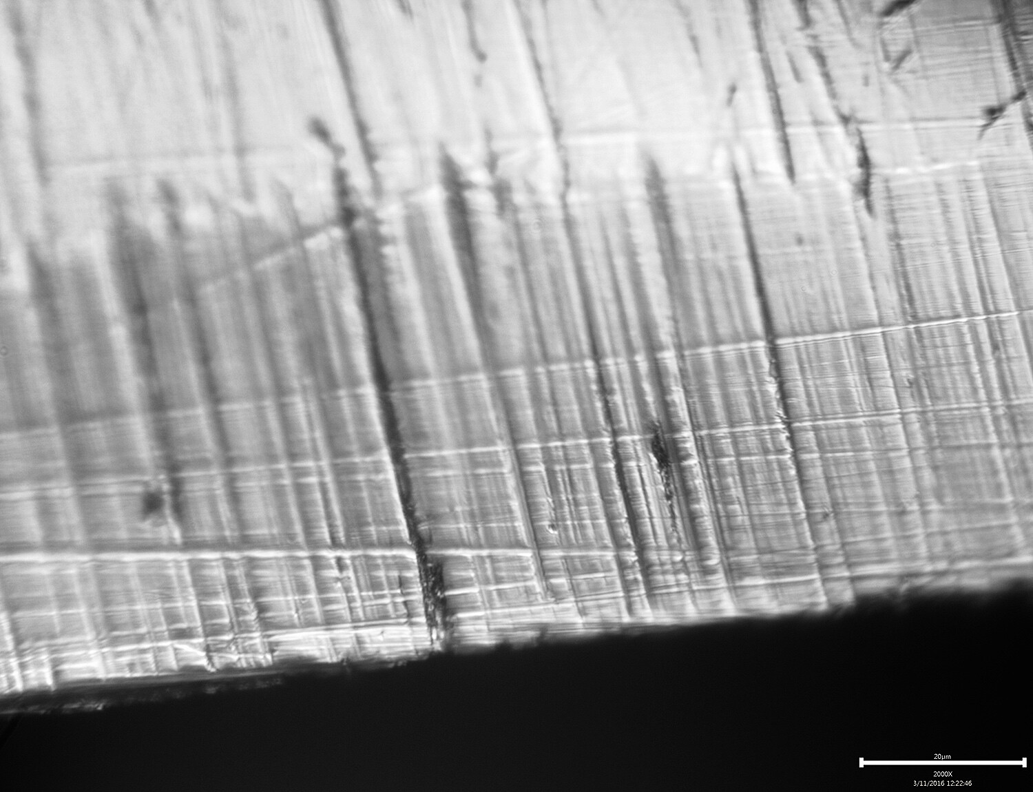

Okay, now the pics… These are at 2000x. I went pretty quickly, so they’re not my best work, but I think they still show the differences in stones pretty well. First I created bevel at 15° and polished it to an acceptable level. It’s messy looking but actually pretty clean. I didn’t have any kangaroo strops in my office to make it perfect, I’ll save that for another day. Then I divided the blade into two sections and created microbevels with both the Micro-Fine Coarse and the Superfine Fine stones at 20°. Here are two images of the microbevel created with the Superfine stones:
The above images have are the same area, one is focused at the edge and the other at the shoulder of the microbevel.
Here is the microbevel created by the Micro-Fine Coarse stones:
It’s interesting to me that the scratch pattern of the Superfine stones is clearly rougher but the edge is cleaner than that of the Micro-Fine Coarse stones. I believe it’s because the Micro-Fine stones are so much harder than the Superfine stones.

Thanks for doing your experimentation Curtis, makes me curious and want to investigate more. I guess I’ve sharpened just about everything that’s out there these days, maybe with a couple of exceptions. Steels like M390 don’t seem too different though I didn’t work on them with an eye as to whether they’re harder to polish. I’d like to study it. Can you recommend a couple of knives that I might test it out on that won’t break the bank?
Curtis,
The more I’m thinking about it, the more I’m wondering if the hardness of the MF Ceramics could be creating the higher polish. I was only looking for scratch sizes, not luster. It makes sense that a harder material would burnish better and I do think I was seeing some of that with the MF Coarse stones. The surface appeared smeared and I think that would make it shine more. I wonder how I can test that. I also wonder how we can measure luster or brightness. Any ideas anyone?
