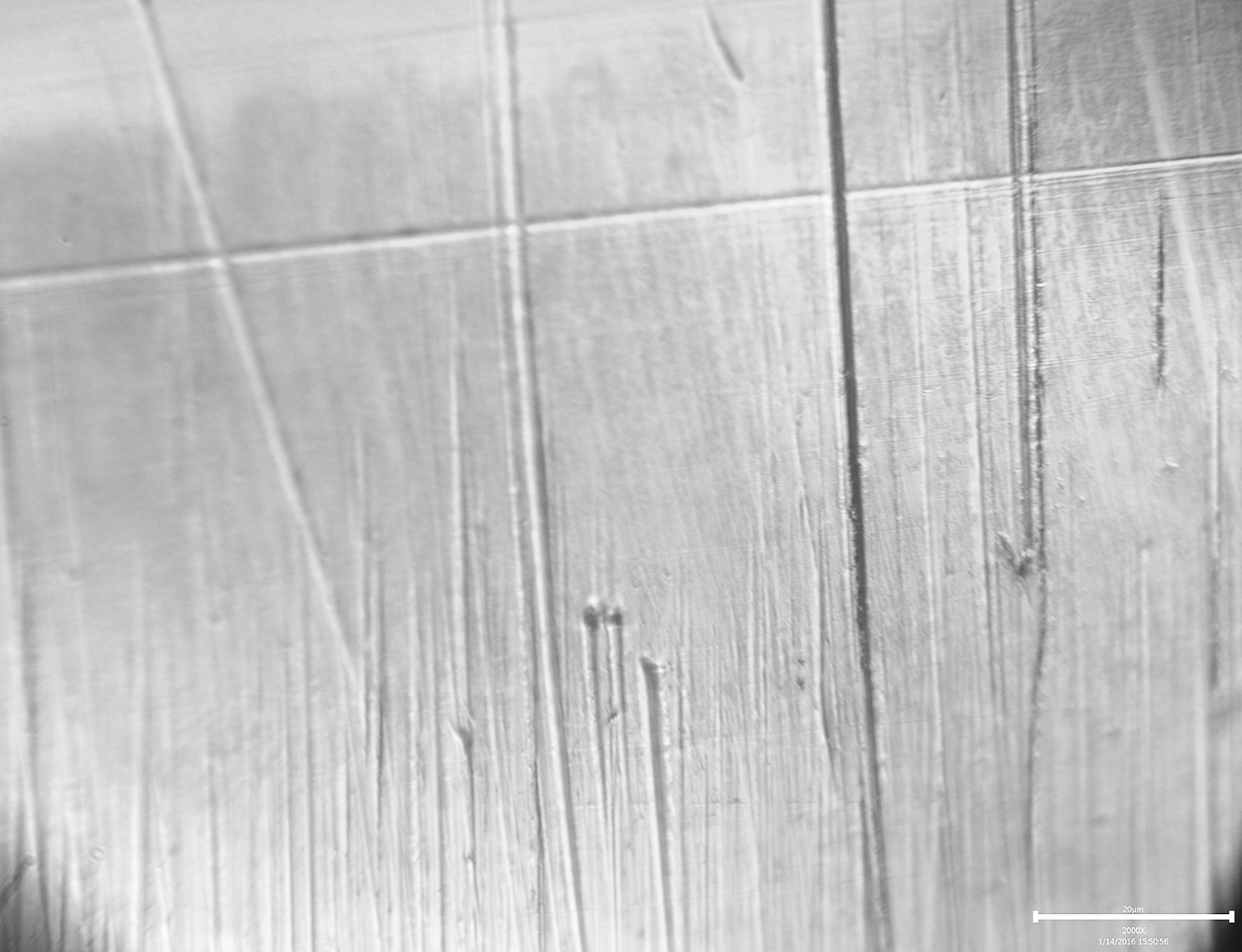

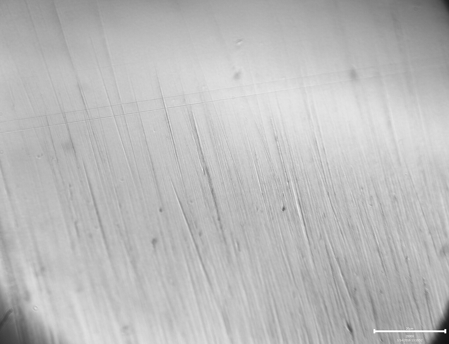

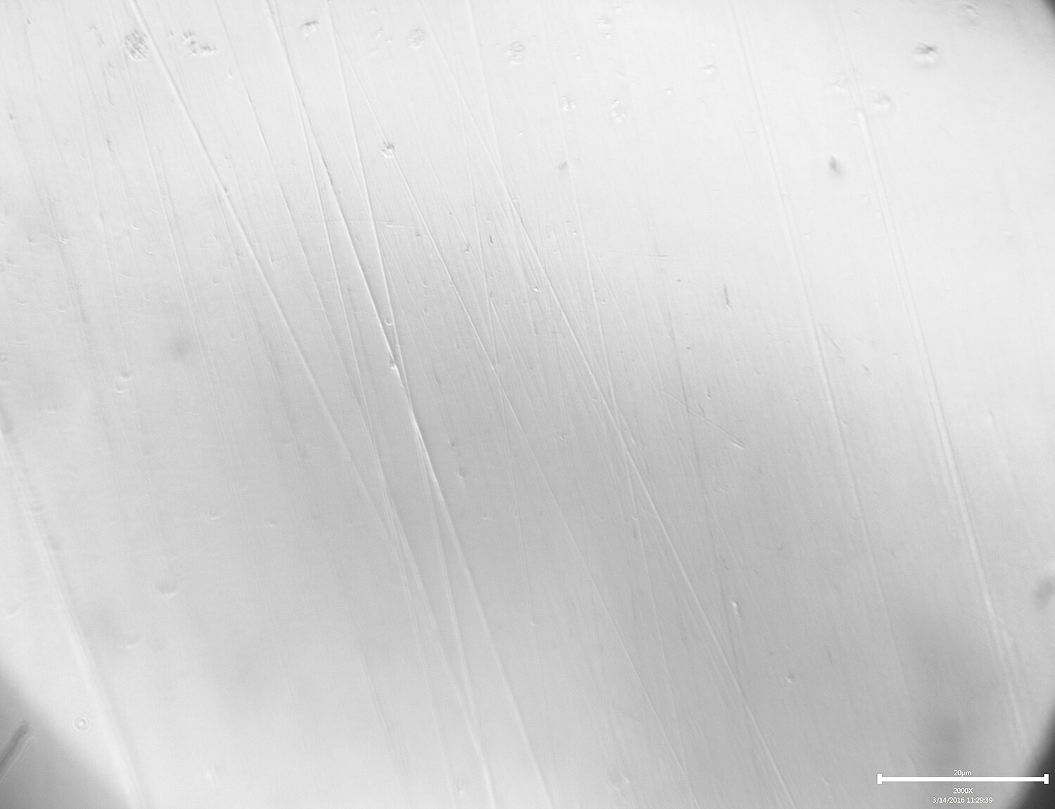

A few more pics this morning. I decided to clean up the primary bevel of the sample with a new set of diamond lapping films and the kangaroo strops. Here’s what we’ve got so far:
.5µ Diamond Lapping Films
[attachment file=“.5-micron-film-A.jpg”]
.25µ Diamond on Kangaroo Strops
[attachment file=“.5-micron-kangaroo-A.jpg”]
.1µ Diamond Lapping Films
[attachment file=“.1-micron-film-A.jpg”]
.125µ CBN on Kangaroo Strops

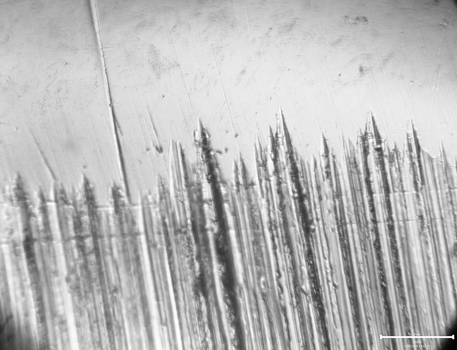

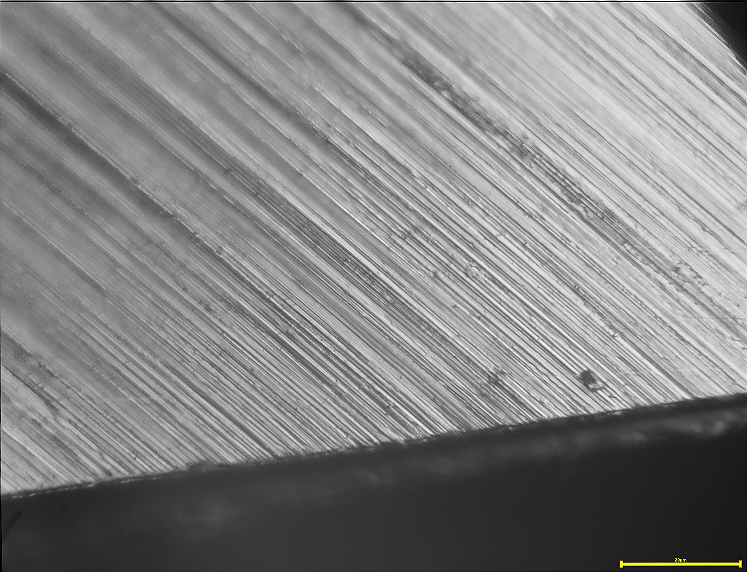

Next I’ll look at the 1200# and 1600# ceramics on the micro-bevel. I decided to clean up the micro-bevel first, so I started with the 6µ films:
Here’s the primary bevel, polished to .25µ diamond on kangaroo:
[attachment file=“.25-micron-kangaroo.jpg”]
And here is another look at the 6µ edge with measurements of some of the scratches:

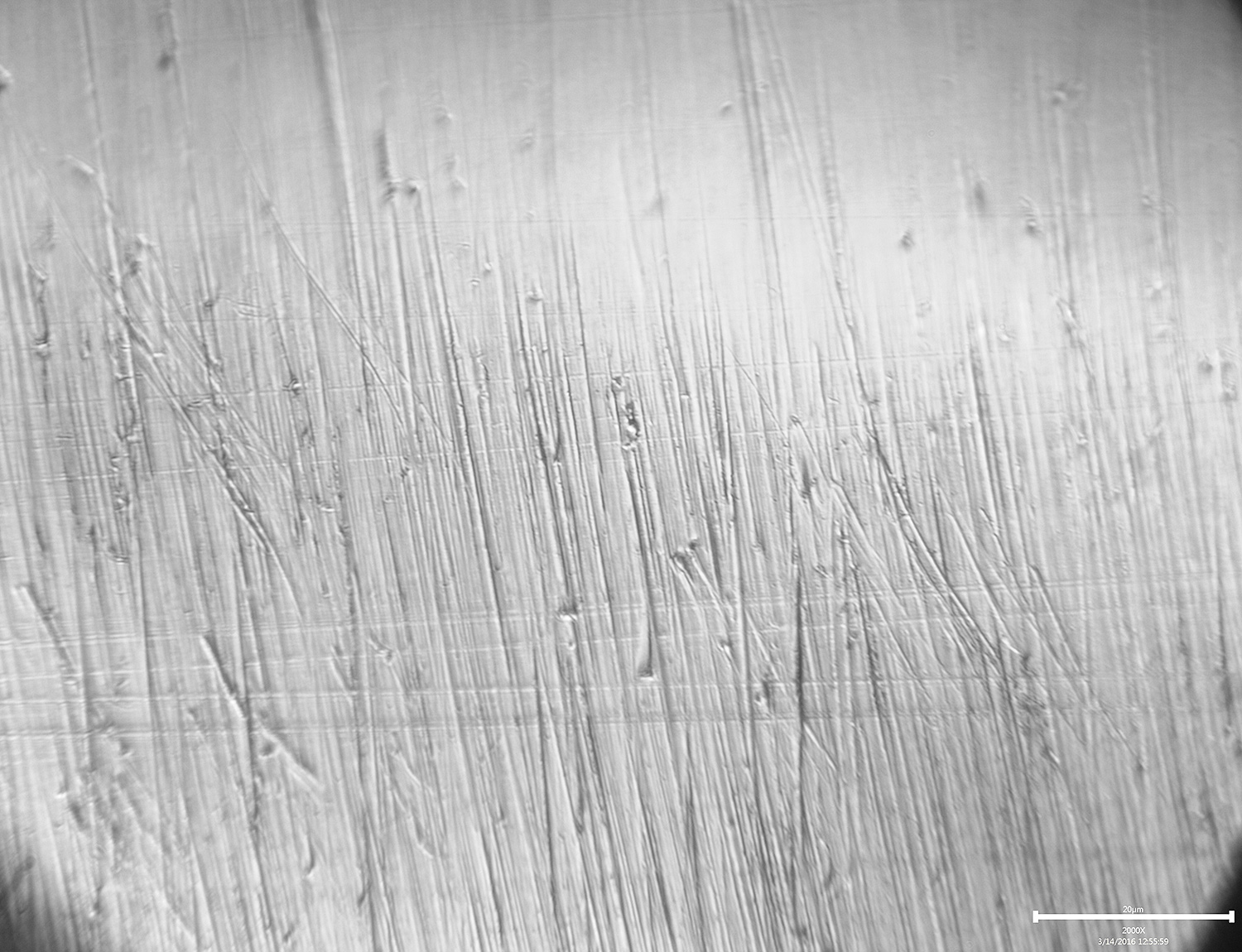

Then I proceeded on to the 1.5µ films:
On to the Superfine Fine stones for the micro-bevel:
I’m happy to see that the scratches are about what we’d expect:

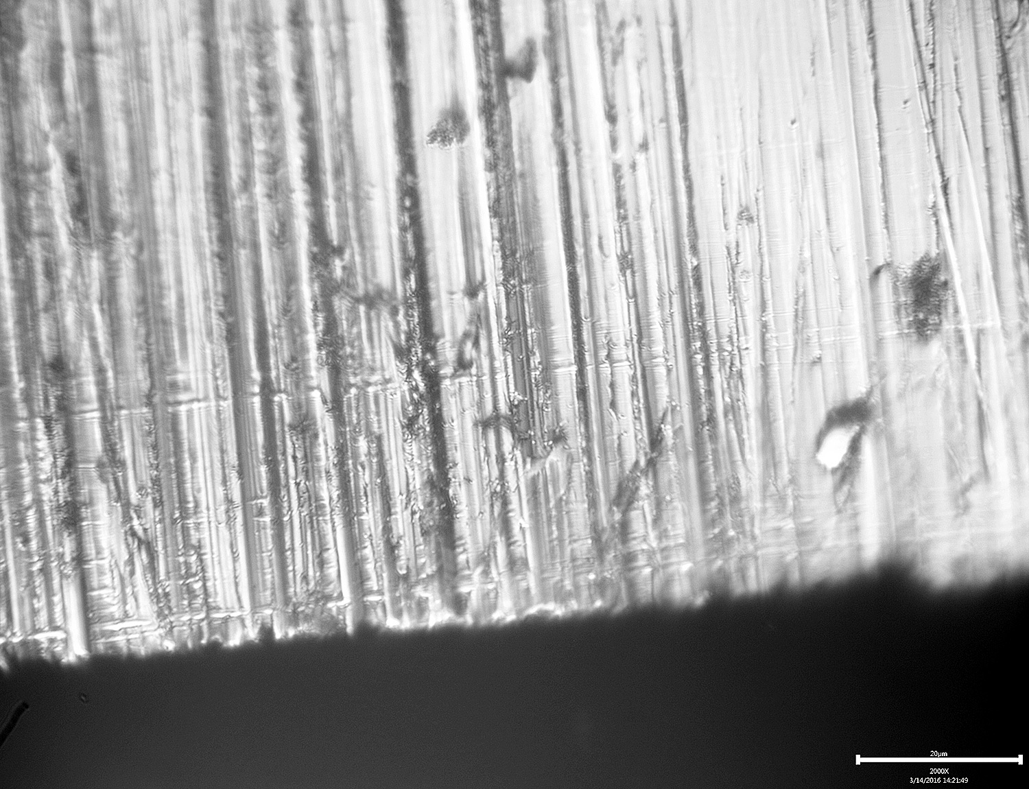

And now the Superfine Coarse stones:
These scratches are also about the right width though they seem more shallow for some reason. I’m not sure what that would be but a guess might be that they’re softer than the fine stones or that the pores are more loaded with filings since they’re more coarse.
Great experiment! Good to see that the superfine stones work about as expected. I’m also curious how the microfine ceramics would come out in an experiment like this.
I already knew the diamond lapping films rule (although there are some unexpected scratches with the .1 micron film?). But the fine diamond/CBN sprays on kangaroo leather also rule.
