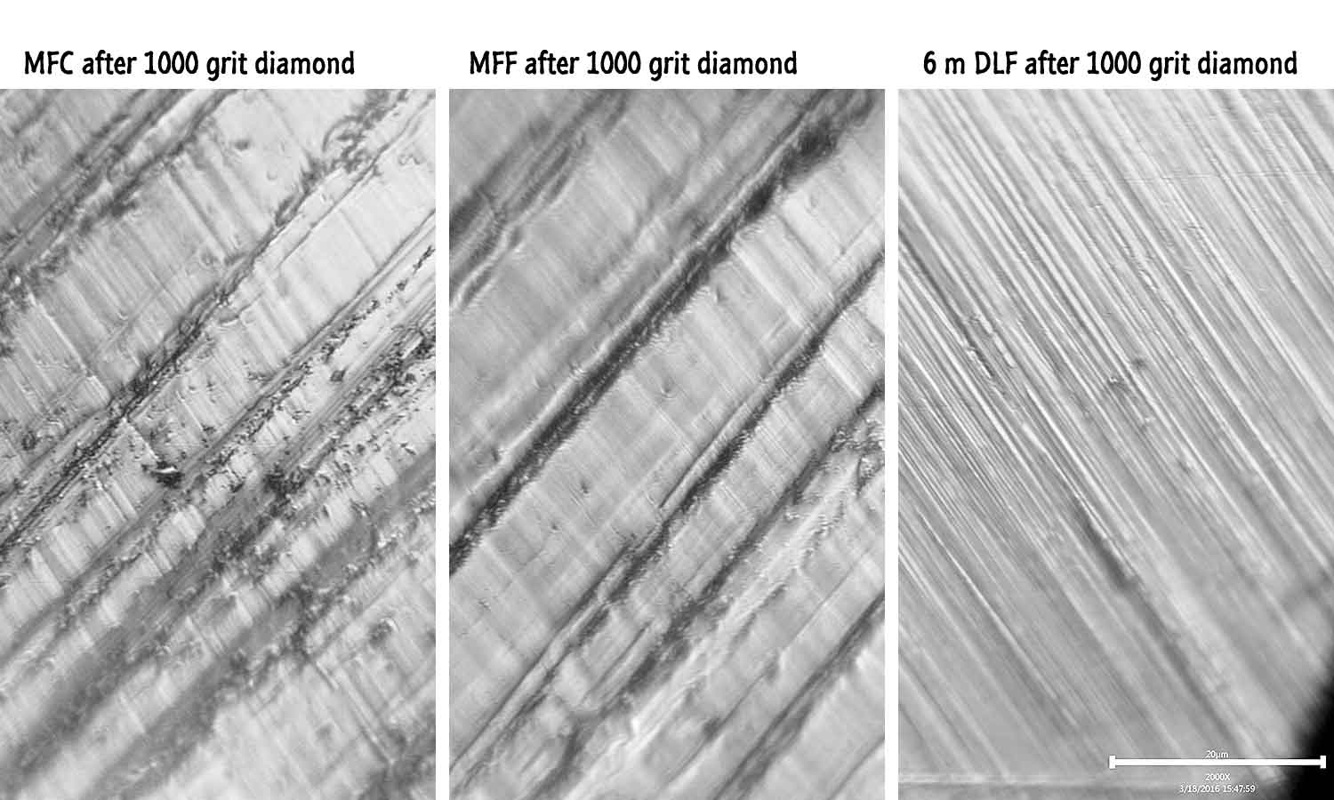

Josh made a good point that you should not take the number of strokes as a standard, since it depends on a lot of variables. This experiment gives an indication for how fast the various stones work relative to each other.
I think it shows that the diamond stones and films work faster than the ceramic stones. Personally it also strengthens me in my opinion that 1000->SF->MF is the preferred order.

Is 6 micron diamond lapping film better for removing 1000 grit diamond scratches than MFC and MFF?
Appears to be the case… from this test anyway.
No. Just faster .
I hope to do some testing soon with my auto body strips to see what grit works for me to jump off the 1000 grit paddles to next…its somewhere in the sub 10 micron range, I think…I know once I get to lapping films its a quick n smooth progression down to sub 1um.
[quote quote=32269]
No. Just faster . [/quote] In this test case faster is better. MFC and MFF makes smoother polish, but they are not as good at removing scratches as 6 um film in the same number of strokes. MFC and MFF should be used after 6 um film (if at all). I would never figured this out without Clay's test pictures.
