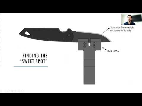

Here’s a video from Wicked Edge that may be helpful:
