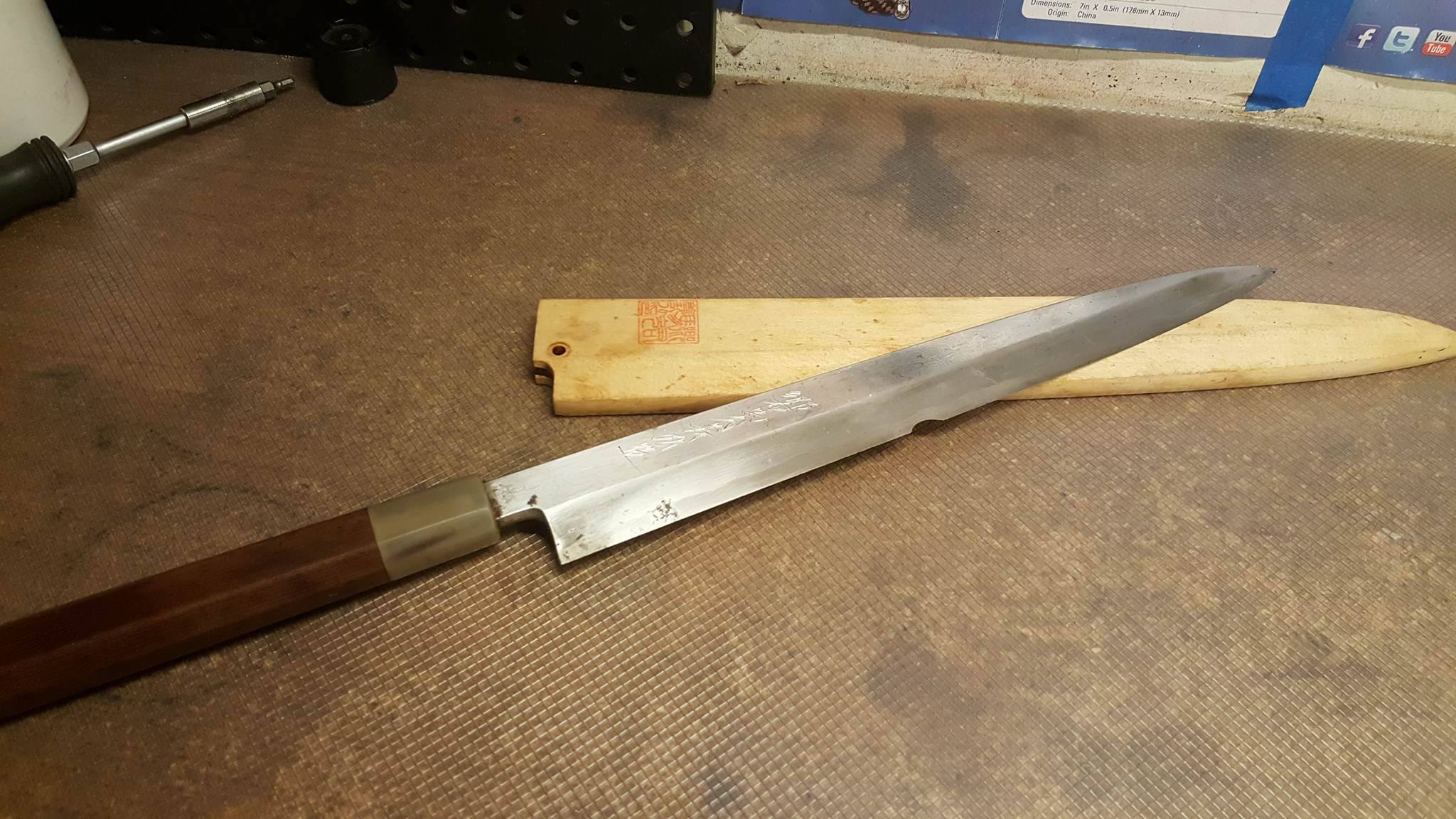

This beautiful $800 sushi knife came in last week. It has an 11" single bevel blade and the chip out is massive and truly painful to look at.
The young chef is not wanting to spend “more then $20 or so…” to repair. Even with a water cooled belt system there is hours n hours of work here to reprofile then entire bevel and keep it even. The backside will need reprofiled as well because the chip goes up under the softer cladding steel.
To repair this would be a high water mark of skill in the art of sharpening(for me), but is it worth +5hrs of highly skilled labor? For $20-25 bucks? Ummm nope…not for me, not on this one. It would seem there is an invisible fine line between trying to make a name for yourself and also under valuing your own skills and time?
Agree totally, thanks for sharing Cliffcurry!
Cliff,
I totally agree as well. I might offer to buy it from him if he’ll sell it cheap and then rework it for myself.
