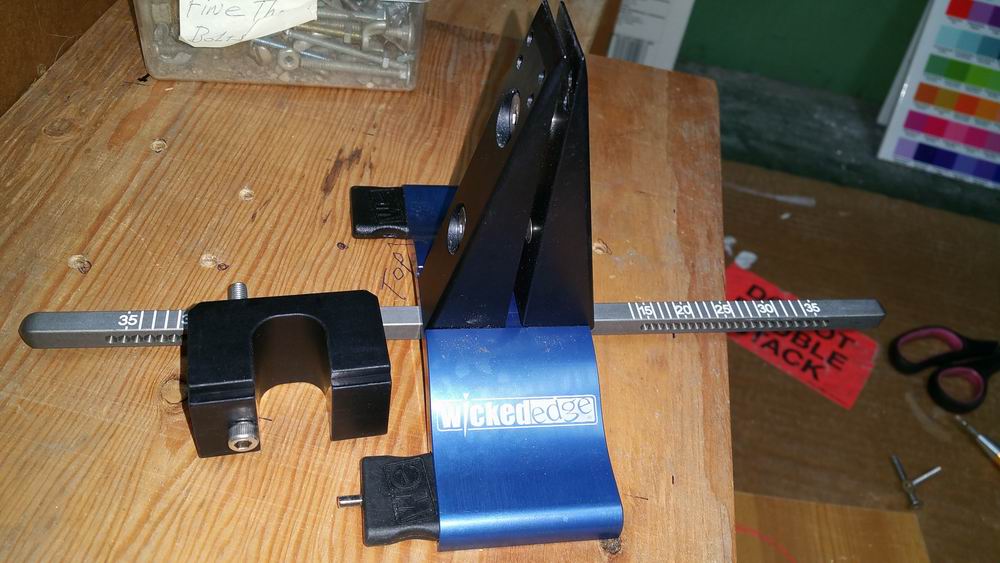

While waiting for scissor attachment to arrive, I took the riser block off.
Now it goes to 45 degrees easily, so I have freedom to easily move around that 40 degree range to clear the sharpie and approximate factory angle (which is usually around 40 degrees)

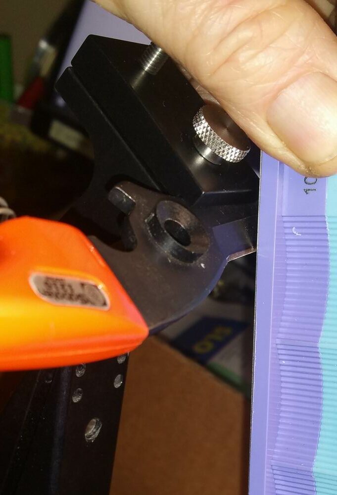

Here the scissor attachment is on. Of the 3 positions this is closest I can get to factory angle but can’t clear the sharpie off anything but the apex.
Celestron USB close up. Best I could do with scissor attachment on this particular hoof shear.

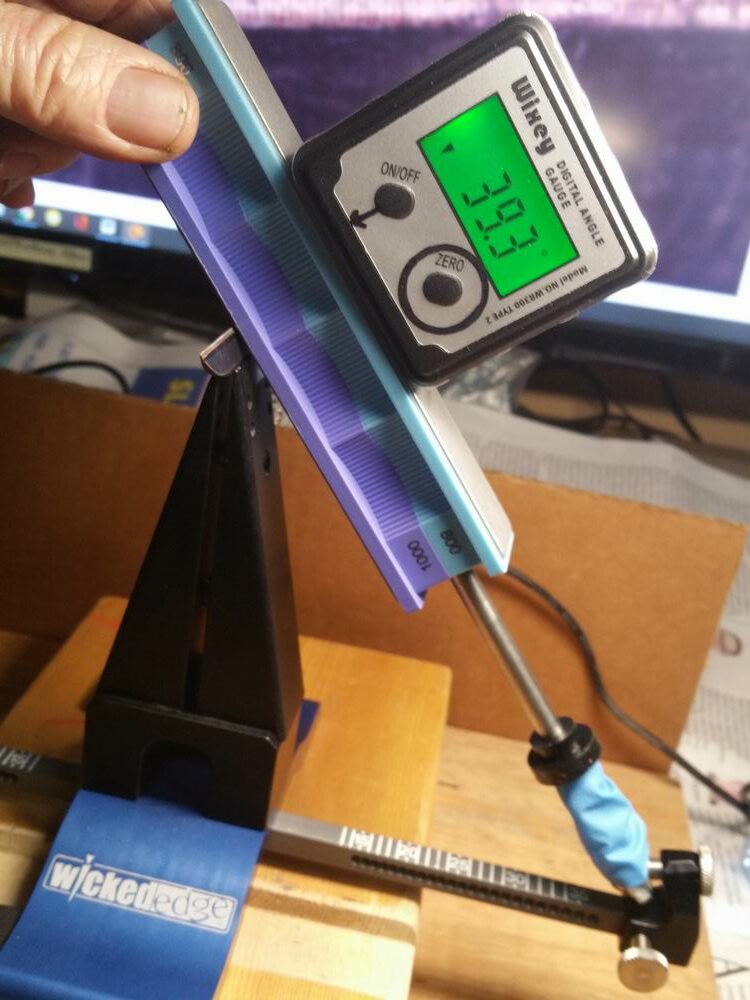

WE120 with arm moved outward as far as it can go.
Closer in.
At this point, I think I am going to do all my long kitchen knives while the riser block is in place. Then remove it so I can do the constant supply of dull goat hoof shears, and still do the average length knives, my Paramilitary 2’s etc. without riser block.

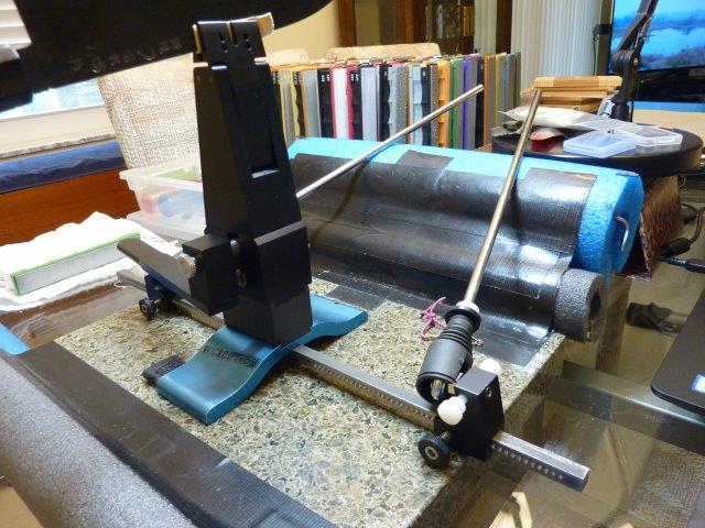

Bob, the Wicked Edge steel square bar is 5/16". You can replace it with a longer bar. It probably needs to be 14" or 16" longer, overall. Then you’ll be able to achieve the wide angle settings needed to sharpen the hoof sheers with the SA while the riser block is still in place. The longer square bar won’t effect your knife sharpening ability. You will have to learn to work with a flat sided square bar without the delineations or angle indents. The mini L brackets can be locked in place against a flat square bar if the set screw pointed tips are flattened. You may find it’s helpful to use two 10-32 set screws for each side bracket. One screwed in from the front side and a second one in from the rear.
If you want to pay the expense you can have a bar machined with the indents. I met a guy that did that for me years ago as a one-off deal. See the attached photo showing my modified setup.
The new square bar will need one hole drilled up through the square bar to secure the bar up underneath the blue W.E. mount and up into the stationary left vise side. If you have the tools to do metal fabrication you may be able to cut and drill the 5/16" steel bar yourself. If not a local metal shop, machine shop or welding shop can easily knock it out.
Coincidentally the 5/16" steel is the same dimentions as many rotisserie rods like those used on an outdoor BBQ grill rotisserie accessory.
I made this modification to my W.E. setup many years ago to improve my overall angle range I can achieve. I work with this longer square bar in place all the time.

The longer bar doesn’t affect how you sharpen knives. You don’t need the low angle adapter, (LAA), unless you needed it already with the original length bar. The longer bar simply gives you a wider angle capacity you lacked with the regular length bar.
I needed the longer bar because I use an extra riser block. This allow me to achieve lower angle settings with just the W.E. vise, without the need to use the LAA. When I gained the low angle ability it was at the sacrifice of the wide angle ability. It’s a compromise between low angle and wide angles.
That’s just what you found when you removed the riser block. You lost the narrow angle ability you need for knives. In order to have a narrow angle range the riser block is used. Then to improve the wide angle range with the riser block still in place you found you needed a longer square bar to allow you to move the end brackets wider.
By using both the extra riser block in combination with the longer square bar I expanded my overall angle range, both low and wide settings.
FYI: some rotisserie bars are not exactly square. Some are sort of rounded out in the flat sides. This is to help them insert through meats that your putting on the spit.

In this photo, I have the rod-arm moved outward as far as it can go on the WE120 and the sharpie is only removed from the apex.
I knew that I was getting the tool for something other than what it was intended for (scissors). The angle of these “goat hoof shears” tends to be about 40 degrees which is just odd. I just did some garden pruners, the factory edge was 36 degrees and I could do them with the Wicked Edge standard out of the box set up. So I realize that I have an odd-ball application.
