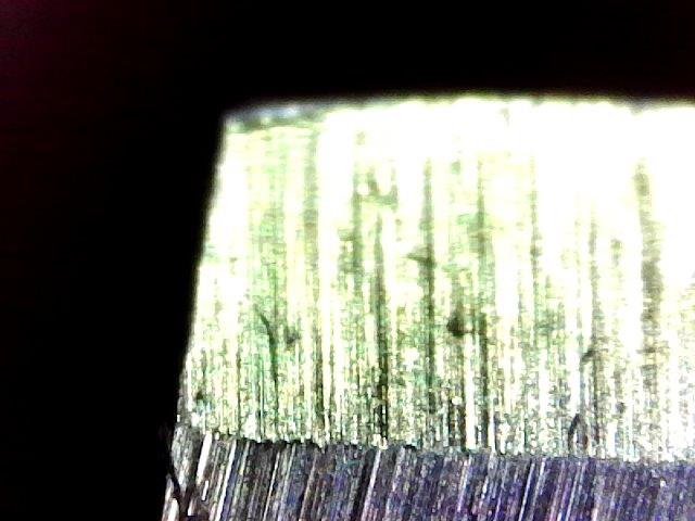

Next, with the knife positioned and clamped, I like to inspect and photograph, (with a USB Microscope), the knife’s bevel and edge grind to see what I’m dealing with. It gives me a good overview of the knife makers quality control. It allows me to familiarize myself to areas needing my attention possible due to damage or grind inconsistencies. Also, it gives me a sense of the quality of the steel by looking at the type of grind the manufacturer applied. I want to believe better knives have better grind jobs. That may be optimistic.
Here is a 200X USB Mic. Photo of the knife’s heel, (out-of-the-box):
This is a damaged area or a defect I found just forward of the heel:
Here is another shot as we continue to scan forward on the bevel towards the tip:
This is the knife tip. You can see it wasn’t properly ground or the tip has broken:
My overview is the knife is pretty good. It has very few flaws for such a large knife and the bevel is ground pretty consistent.

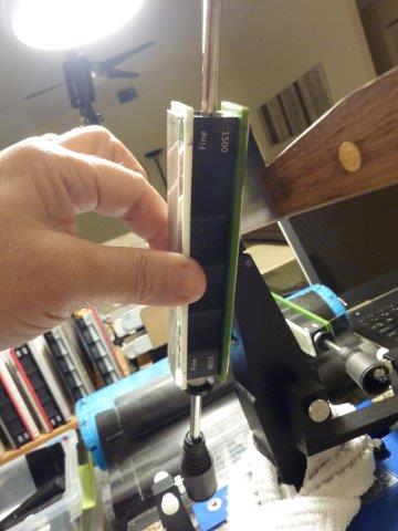

Here are pictures of the lower stone stop so you can see what I use.
Resting on the stop:
Lower stone stop with stone held up above it:
I’m using my extra-long rod arms for this wide knife to make sure the rod arms are long enough to stick up above the diamond stone when it’s even with the bevel height. Here’s a picture of the long guide rods tip:

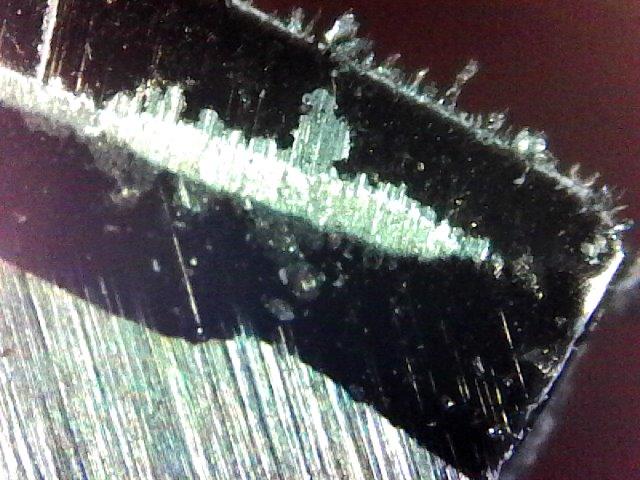

With the knife marked with the sharpie I use the 1500 grit diamond stone and gently run it up and down across the bevel, with a very light scrubbing stroke, to remove the black sharpie ink. My first attempts were removing the ink well in the center of the flat portion of the knife. This doesn’t really mean anything here. It will always line up right on the mid bevel. The tip is the most difficult to align. When I started to find the sweet spot with the knife still level the ink was removed below the top of the bevel, lower down the side of the bevel. This tells me to move the tip down lower to get into the area that the ink was removed by the stone. I loosened the vice and rotated the tip down while keeping the knife heel resting on the one forward key pin. I locked the knife tight then reapplied the ink and retried this position. One try later I was where I could work with the position. Up to this point I’m not even using the AAG.
Here is that mid bevel shot:

Here is that bevel shot, first attempt with the knife mounted level:
The scrubbing stroke removed the black ink on the tip below the knife edge, in this current clamping position. In order to remove the ink from the top of the bevel, (i.e., the knife edge), I need to tilt the knife tip down, or rotate the knife down while the spine continues to rest on the forward key pin. This will move the knife edge into the position where the diamond stone’s scratch pattern can remove the ink.
Here is a picture after the adjustment. You can see the before and after bevels:
Here is the tip in good position, tilted down to be in the "sweet spot:
This looks pretty good. It’s at the top of the bevel which is good because as we remove steel sharpening this knife the bevel goes lower down the knife.
Here is the heel in sweet spot position:
Finding the “sweet spot” is a balancing act. Sometimes you have to quit and leave well enough alone.
You can’t always get every where along the bevel just perfect. Sometimes the ink is removed a little below the knife tip’s bevel. I prefer a clamping position where the ink is removed from just at or below the bevel. As you sharpen the knife you remove steel while the grind pattern grows down lower on the blade.
Sometimes with the mid points, and the heel in good position only the tip maybe slightly low. I would rather remove more steel from the tip then the knife’s heel because with this style knife, a “chef’s knife” you do chopping and use a rocking motion or sliding motion. For these cutting motions it’s more important to have the heel of the knife flat on the cutting board and further forward on the knife at the same time, still flat on the board. The tip of a knife for this style knife see’s relatively little use and it doesn’t contact the board at the same time when the belly and heel are flat on the cutting board.
At this point I decided I could work with this position. Remember next time this knife is sharpened, any little bit of steel we’ll remove to profile this knife to conform to the fixed angle sharpening of our Wicked Edge Device, this first time, will not need to be removed, again. The knife the next time should line right up with maybe only a little tiny adjustment needed.

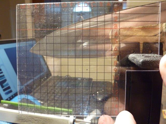

Here’s the Advanced Alignment Guide. It’s up to you to log these dimensions or coordinates in a manner that makes the most sense to you so it is repeatable. Here’s a picture of the mounted knife with the “Advanced Alignment Guide”, (AAG) in place:
I would record:
  1. bottom Key Holes
  2. tip at middle of “L” on the “6” Line
  3. jaw tops are 1/4 space above (5) line, and parallel
  4. tip of the upper right corner of AAG crosses right on bevel
  5. Black Vertical between (G) and (H) crosses red horizontal (3) on bevel
With 5 points I don’t think you have to worry about getting it lined up again to sharpen or touch up this knife.
