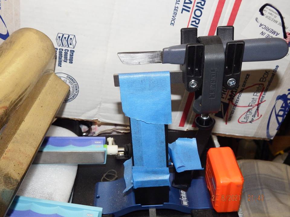

Where you place the cube against your stones, how high or how low on the stone. Then how your stones are placed while leaning against the knife edge. Again, how high or how low the stone is relative to the apex. Are you holding the stone in that position? If so, with how much finger pressure and where are you holding it, placing your fingers. Or, is the stone simply resting or balancing against the edge?
Every little thing effects the readings. Due to the sensitivity of this cube.
I prefer to rest my stones centered with the vise on the knife edge while it’s held up in place centered top to bottom, with a lower stone stop. I take all angle readings this same way, every time. This is simply my attempt to remove any chance for differences in readings due to method and inconsistencies.

Yeah, it does take more time. I spent nearly 3 hours on my leather knife taking the edges up to my new 3000 grit stones using my new Tormek SVM-00 small knife jig at 16dps. One side was exactly 16dps and the other side was a little off so I reprofiled it to 16dps. Even though my new 2200/3000 stones are not broken in yet, they still did a pretty good job.
