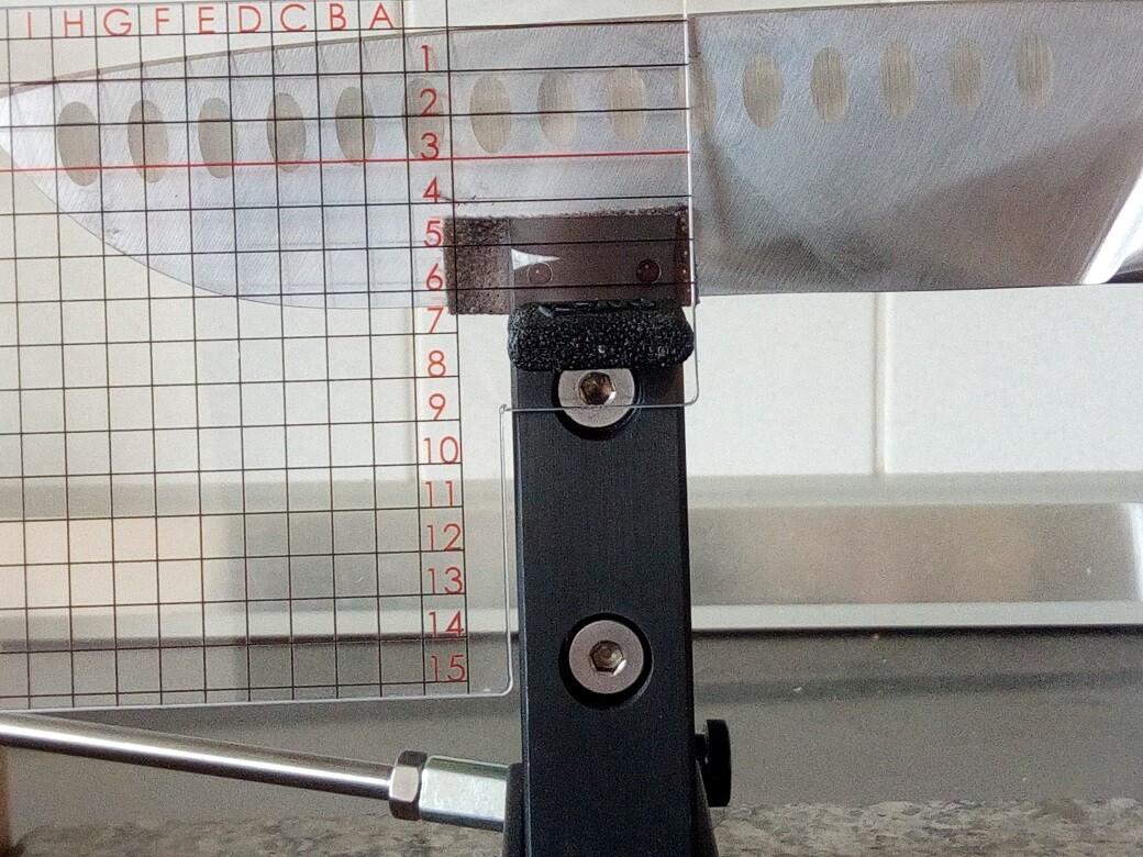

The Alignment Guide when used with the lower depth key holes, blocks the clamping screw making it almost impossible to tighten the knife while using the guide for the correct position.

I suppose you could drill a hole in the AAG to give you access to the upper screw, but before you put the AAG in place, you should already have set the upper screw to its correct position; which is in most cases to set the gap at the jaws to the thickness of the blade. Then, with the blade held lightly by the upper screw, to move the blade to your desired AAG setting and then to tighten the lower screw.

Yes, I already thought about drilling a hole in the AAG which will solve the problem.

I notice your alignment guide site very square. I purchased one recently and the holes are a bit large so mine site at an angle due to the play. I need to sit the corner where the no 15 is against the jaw to make it sit relatively square
