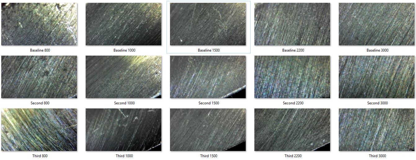

I don’t use the burr method. I concentrate on forming the apex using the handheld microscope. Burrs look like a dull edge, but you can identify them by seeing if they move when you switch sides. Mainly, I’m looking for an apex that doesn’t reflect light. If I see reflected light, I swing the camera to the side to look for a crisp, straight line apex. If I see a slight indentation along the edge, I know I need to work the apex further down.
For example, if I see a fine line of reflected light along what should be the apex, I have to decide if it’s a burr or a section of edge that hasn’t been fully apexed. If it’s really thin and I’ve been working that part of the edge for a while, I may decide that it’s an edge that hasn’t been fully apexed but that it’s fine enough to let me finish the apexing with the next grit. If it’s a burr, you’re ready to move onto the next grit anyway. Experience will teach you these sublties.
tcmeyer, which camera do you use and at what magnification? Sounds like you get a lot of value out of it, which I would like to try to replicate. Thank you
I have several cameras, but I always come back to the Celestron 5MP. I posted a video on how I use it on Youtube, It’s a bit out of date but you might want to check it out. Once you learn to use it quickly and effectively and make it a part of your process, it becomes automatic and you’ll rely on it heavily. I never, never sharpen knives without it.
I just realized I didn’t answer about the magnification. I use the face of the clear plastic shroud as the fixed reference, which I place against the edge as I slide the camera longitudinally to inspect the edge. At that focal plane, the lens will focus at two different magnifications. On my 21" wide screen monitor, the lower setting is about 50 - 55X. I don’t recall offhand what the higher magnification is, but I think it was something around 200X, which was too high, as the depth of field is too low and makes it difficult to keep in focus. Even at the lower magnification, I often have to tip the camera a bit to raise the focal point. This happens where the edge is curved. I set the focus for a straight section of edge, the use the “tipping” method as I move toward the blade’s tip.

It’s really true that instead of feeling for a burr, you can use the USB microscope (or really just your naked eyes) to see the light being reflected off of what want’s to be an apex. I have high intensity LED lights shining on both sides of the blade and it’s really remarkable how great that method works.
