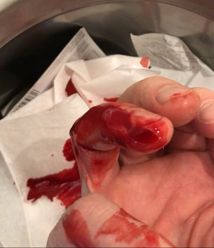

So I’ve been using the WE for a few years now. During that time I was never cut by a knife on the clamp and have become very comfortable with the hand motions while using the system. Recently I changed my system and I think that contributed to my first bite.
What happened was, I use my pointer finger as a reference point on the right arm, and look from the left side across the edge of the knife to where my finger is, and move the arm back and forth roughly representing the path of travel of the arm so I can quickly narrow down the sweet spot.
Well, I guess just the new system showing my muscle memory to be misplaced, and being tired on Christmas, I let my ring finger dangle and this is the result:
Like many others, I’ll be using cut resistant gloves from now on.

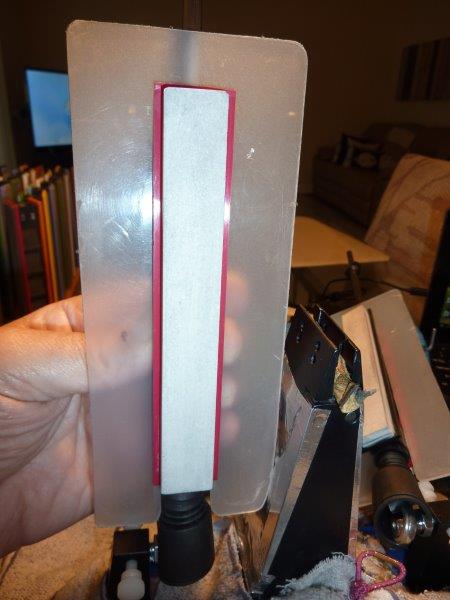

I experienced a similar situation when I tried to use gloves. I did notice from time to time that my glove covered finger tips did still bump the knife edge. After inspecting the glove finger tips I saw where the knife edge had sliced the protective rubber covering from the glove tips. That made me realize every one of those cuts were an avoided finger tip cut. Eventually I was going to get cut! I was happy the gloves were working but I wanted to avoid contact all together with a sharp knife.
That’s when I made myself these safety shields,
and shortly after that Clay posted that Wicked Edge had a similar safety shield product on the website available for ordering.
I still every once in a while feel the plastic bump the knife edge but its harder and thicker then the glove finger tips. Also I no longer have to keep removing the gloves to check my knife edge for sharpness.

My finger is getting better, no more scab but still missing some flesh. In that pic there seems to be bumps on my finger and one person asked if that was a flap of skin from the cut. However, those bumps are actually drops of blood running down my finger, so you can see how much it was bleeding. Pic was taken about 30 minutes after the cut, after I stopped the initial bleed, finished the knife and then had to remove saturated gauze as I underestimated the severity of it. That is when I took the pic.
Gloves will need to be removed to check sharpness, but this cut has taken weeks to heal and my finger might not be the same after. I have a baby to care for and a house to clean regularly, so this cut has been a massive inconvenience having to wear disposable gloves to change diapers, do dishes and prevent it getting wet. And this wasn’t even a really bad cut. I also bought the WE Guards, but I haven’t used them yet.
