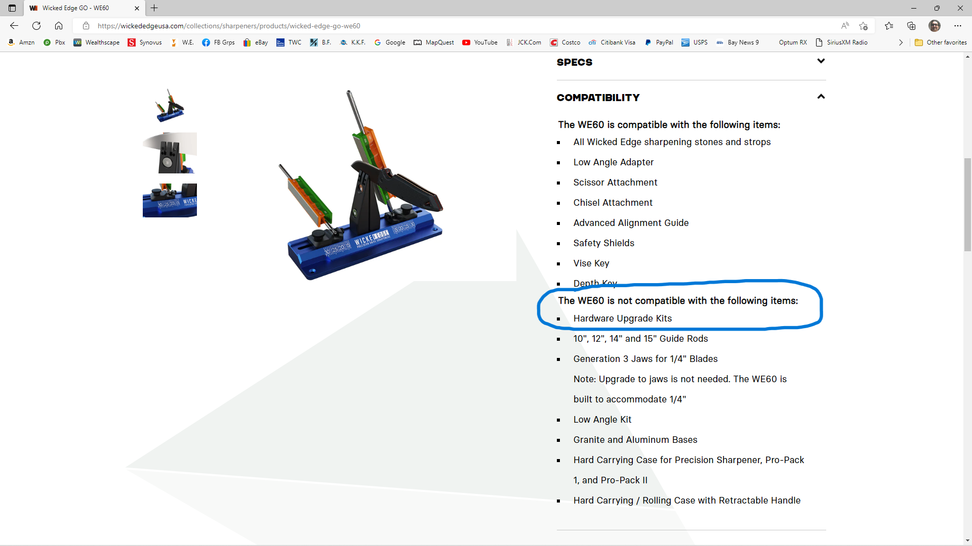

The WE60 is not upgradeable:

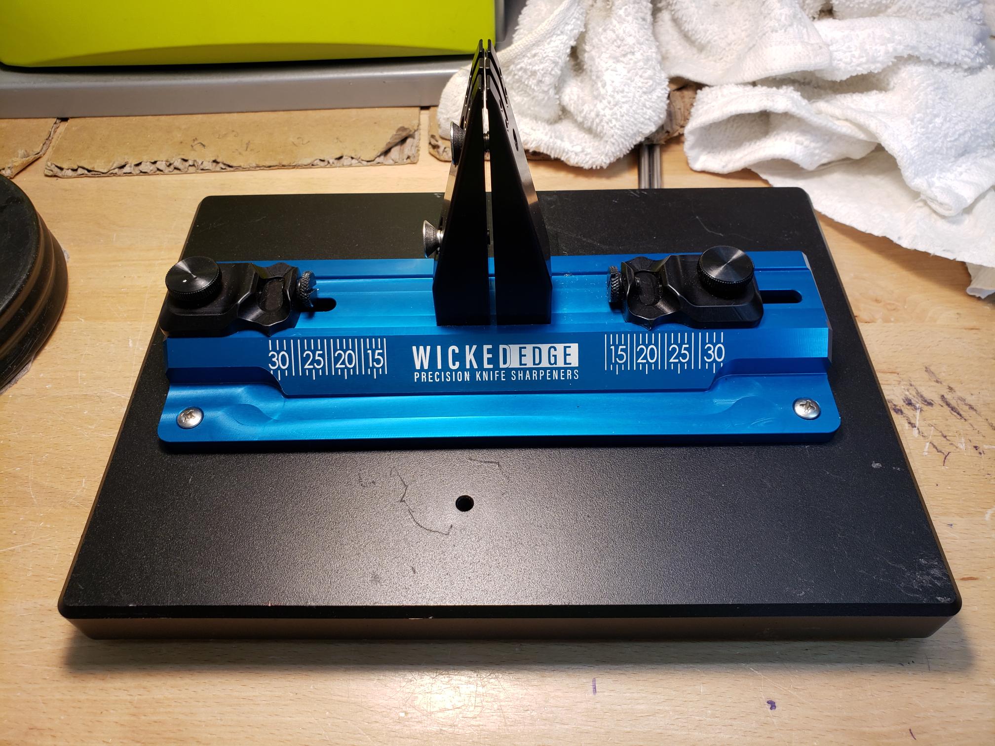

I mounted my new WE60 on the base from my WE120.
Not having ever handled any WE GO, I’m curious, can I ask why the GO WE50 needed an upgrade to this WE60?
Is it cheaper to manufacture or smaller to carry or?
My inexperienced eye tells me it may be a backward step, be kind with your opinions please. :wink:
All I know is the original WEGO, (WE50) was an extruded base. This new WE60 is machined. The WE60 is a single, stand alone model, it is not upgradeable. Another, better optioned model, based around this compact WE60 format is slated for release this fall around Nov.

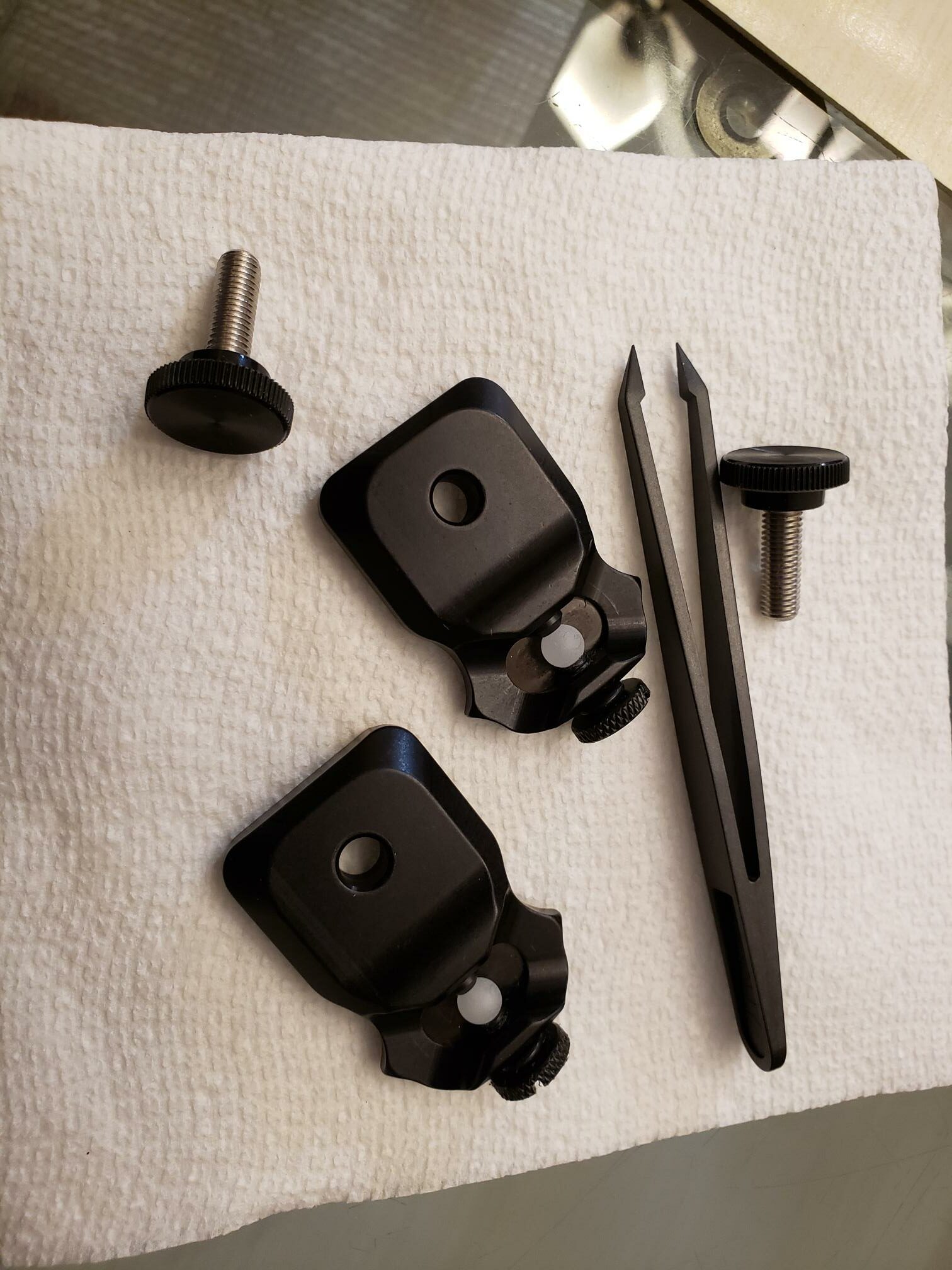

The little white "keeper" balls need to be saved to reposition them whenever the ball-end guide rods are removed. These "keeper" balls hold the delrin pivot sockets in place so they won't fall out and get lost.
Marc, I am guessing a tiny dot of grease on the shaft of the “Jesus sockets” before putting them on the housing would help in the not getting lost department. I can not see the balls being successfully kept with the way the product is packaged, the fact the are tiny balls and no big warning on the package saying not to toss them out when you assemble the sharpener.
I thought about using a dot of silicone sealer to cement the sockets in place. The dried excessive could easily be trimmed away with a razor knife.
I assume that part rotated in the housing if need be, have not taken mine apart to look at it, grease be it petroleum or silicone would cause the socket to “stick” in the housing but still move as it would be lubricated.. Not sure if that part is supposed to rotate but I assume not so sealant would be fine if that is the case.

It would be interesting to put a white dot of paint or similar on the edge of the “Delrin Pivot Race” (as WE call it) and watch when moving the arms to see if it actually rotates. My guess is that it does assist the process of smooth movement or else it could have been threaded and tightened.
And if it does, will lubricant be advised in the future?

I could not tell if the Delrin retention socket moved while I was sharpening knives. It looked like it stayed put, but I didn’t mark it to see for sure.
I’m going by what I was told. She can call it what she wants to.
Thanks for the great pic’s Marc, I was hoping to get a look at the parts close up. It’s a shame you can’t just use a longer screw to hold the cup part. I can see it would reduce the ability to achieve a lower angle though.
