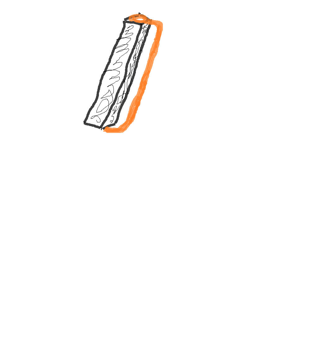

The one thing that I think needs to be addressed with the current paddle design is the lack of sufficient clearance between the abrasive and the lip of the paddles. Knives that are sharpened with an edge that goes all the way to the plunge grind (many Kershaw and Spyderco offerings) are difficult or impossible to do properly with the current WE paddle design. This could be addressed by either removing the lip or making the diamond plates thicker so that they protrude further from the paddles.
