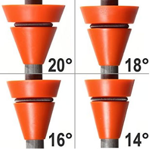

For micro bevel I add 3-5 degrees to main bevel angle. These cones help with the angle consistency ( AngleGuide.com ).
I’ve seen these on Chef knife forums before and thought they were a great idea. I find that the spyderco sharpmaker is also great for maintaining a micro-bevel between sharpenings, but you either have to free hand the edge or use their 15 or 20 degree per side presets.
