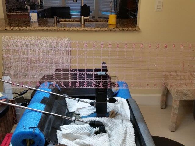

I made a custom modded Advanced Alignment Guide “on steroids”: Here’s what I started with.
I used the depth key to mark my desired hole positions. I used a 1/8" drill and enlarged the holes ever so slightly to maintain a very tight fit on the depth key prongs. It stays in place! I used this long/wide ruler to allow me to record positions of knives mounted tilted in the vice and to align very long, wide and large blades. I may cut it shorter after I use it for a while if I find it’s length is excessive.
Here’s without a knife in the vice:
Here’s with a clamped Large Chef’s Knife:
Here’s the backside view of the clamped knife:

@ Marc H…very innovative. Does the “Marc H AAG” sit perpendicularly to the base…i.e., parallel to the blade?
Actually, the AAG is parallel to the vice’s jaw line, and the base. The blade is not parallel because it’s rotated some to optimize the sharpening efficiency. Each knife I position as needed to best utilize the “sweet spot.”
