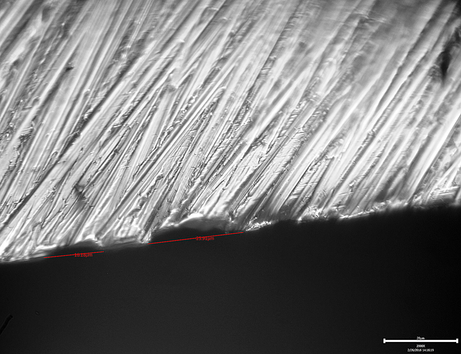

I think you’re right. What happened here is that you’ve been checking your progress at 2000X, which would take forever to examine the entire length of the blade, thus missing damage still there from previous grits.
I think your exercise here validates what I’ve been preaching to newcomers about being sure that you’ve removed all the damage before moving on to the next grit. I inspect the entire length of the blade, but at only 50X. At this low magnification, it’s hard to see the type and size of edge damage you’re seeing at 2000X, so I scan the entire length of the blade from directly above and stop to check any suspicious spots. Swinging the 'scope from side to side, you can usually see slight dips in the edge, but probably not much below 25 microns. Maybe you could inspect full-length with a 200X handheld before dismounting the knife for the 2000X inspection.
The improvement in the edge seen with the 6 micron film is amazing. Did you do any grits between the 1000’s and the 6 micron?
I think you have it pretty well nailed. I can even seem most of those little chips with the 60x loupe if I’m diligent.
I did not use any stones in between the 1000# and the 6µ films. Impressive. Especially since they are well used already. For contrast, here are some shots of the blade after the 3µ DMT stones:

Clay, when you went to the films were you matching the angle? And was it a microbevel angle you were matching or the full bevel width?

I matched the angle and did the full bevel. Of course a micro-bevel would be a lot quicker and easier and I think the films would be a great way to be very efficient. If a person wanted to a nice plan to go from start to finish, it might look like 100# to re-profile, but not quite to the edge. Then work their way to the edge as they go through the rest of the diamonds until the reach 1000#. Then a quick micro-bevel with the lapping films to get the apex and done.
