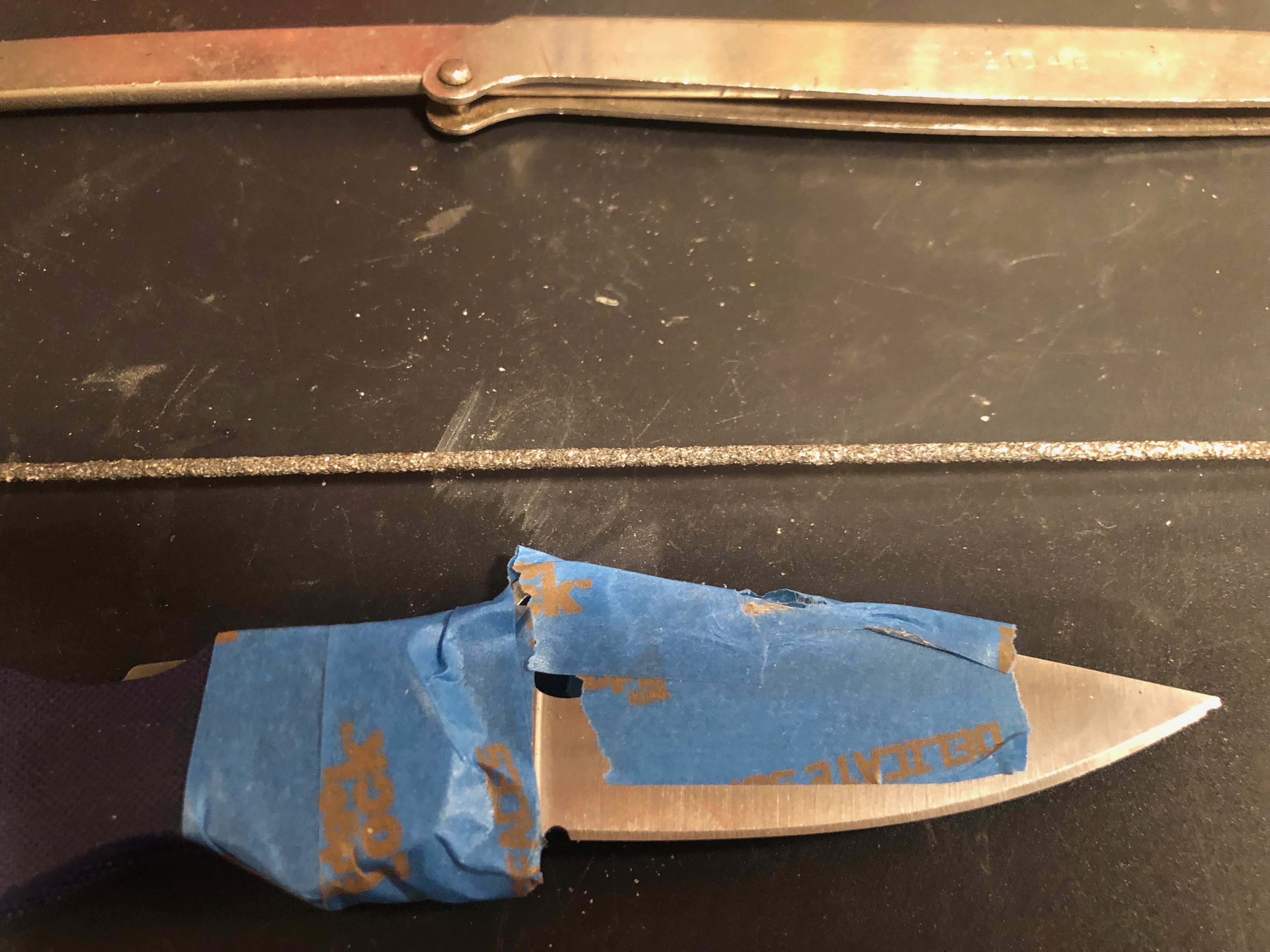

I love this system. Clay is a sharpening “genius”! So I first took Marc’s suggestion to put in a sharpening choil. I found a round diamond blade that is held in a hacksaw. Did the job in no time. Then I used TC’s suggestion to just sharpen it as normal until the chip is gone. I used the Tormek adapter as 15 degrees is such a low angle with a small blade.

sharpening choil added

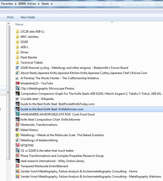

Nice setup. I dabble in material science as a hobby. Attached are a couple of pics (one of my Favorites and the other from the WEPS Knowledge Base).
I recommend the Verhoeven works greatly as they have a lot of well written technical info.
