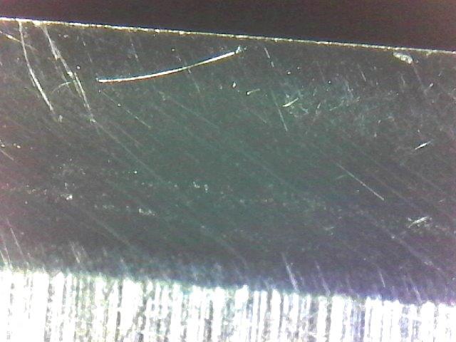

Here’s a photo from USB Microscope (supposedly @ 250X) of the bevel edge of a Yaxel Gou Kitchen Knife made with SG2 Stainless Steel which is a microcarbide powder stainless steel hardened to Hrc 63[attachment file=“Yaxel Gou Edge.jpg”] You can see the bright horizontal bevel with all its little microchips, pits or bumps. The side of the bevel appears almost dark because it is very smooth and polished but it does have quite a few tiny wispy scratches across it. I have used this knife some since it’s last sharpening.
Great thread, Marc! As we discussed in my Maxamet thread, yes, I’ve seen similar results on hard, high carbide steels. Switching to a different media (in that case, the micro ceramics) made a huge difference. It may well be that if I could examine the edge under even higher magnification I would still see this but from a practical perspective the edge left by the micro ceramics is very clean, lacking the chipping/pitting evidenced by the Atoma plates
I’d be interested in hearing anyone else’s experience and how you tried resolving it.
Ken
