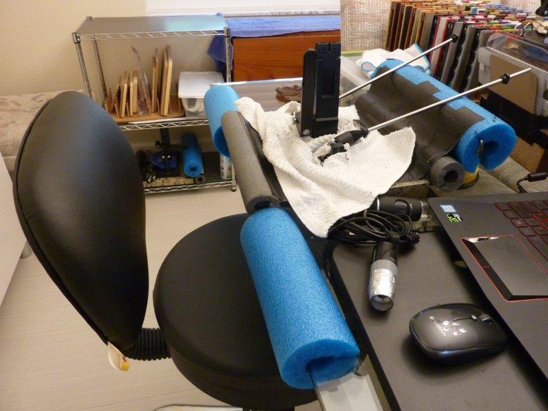

I have used both the foam insulation tubes sold for covering your central air conditioner high pressure copper tube and swimming pool noodles for that application.
Here’s an older picture of my WE130 setup. I have both padded elbow rests and a padded back stop. The towel covering my set-up is because I was sharpening with Whetstones and a water spritz that day I took the photo:
