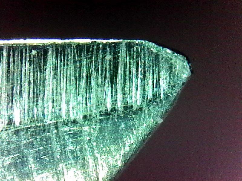

Here’s a couple edge photos taken hand-held. They are of the bevel and tip at high power before sharpening. They show me everything I need to see to do what I want to do.
I recently purchased the Pluggable 'scope after reading the reviews on the WE forum. https://www.amazon.com/gp/product/B00XNYXQHE/ref=ppx_yo_dt_b_search_asin_title?ie=UTF8&psc=1
Here’s a sample of what you can expect from it:
Scratch pattern of a 2,200 grit WE stone.
What’s the magnification?
This is 5mm:
These pics are down-sized for posting. When using the camera with my laptop, the image completely fills the 13" screen. The photos are taken hand-held with the bezel of the 'scope in contact with the subject.
I’ll take a stab at the actual screen image width being actually about 5.25 mm wide. If your laptop screen is 13" (330mm) wide, then the magnification is about 63X (330/5.25).
