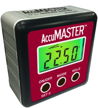

First is the AccuMaster($34 on Amazon):
Resolution: +/- .05° at rest
Accuracy: +/- .02°
Repeatability: Not listed

Accumaster looks nice, but according to folks on Amazon Q&A and reviews, it only has one magnet, located on the bottom. For use on the WEPS, the side magnets are very convenient.
Good to be in the know for new and improved tools, but for now I’ll keep my Accuremote angle gauge.
Alan, Im in agreement 100% and I just wanted to bring it to the attention of fellow forum memebers that there were new product out there. For all I know there could be others but I got excited and wanted to share before doing an exhaustive search. :stuck_out_tongue:
I also like the simpler design and lower price tag of the AccuMaster. Heck for 10 times the accuracy AND an easy to read backlit display, Id be tempted to break out the hot glue gun and a magnetic strip to glue it on the side…but thats just me.
It looks good and nice that it has an even higher resolution. But in practice I'm happy if I can keep angle changes within 0.5% ;)
Update: I ended up springing for the $30 AccuMaster. Only downside I can think of I didnt address is the lack of magnet on the side…Ill probably glue a magnetic strip on the side but its easily viewable at the slant.
Also I noticed a small detail I didn’t mention that the mounting edge is recessed in the middle maybe .3mm which allows for it to seat flush on the paddle much easier. The old AccuRemote is totally flat so any metal dust sticks there and causes a tiny wobble(in mine).
Edit: Pay close attention at the end of the video as the AccuRemote stays at 0.00 while the AccuMaster is adjusting incrementally up & down. Thought that was noteworthy…
https://youtu.be/rFCyOFXMYNY
All in all Im calling this a Win for the display alone and the response time is about twice as fast which is very nice. Makes me wonder what the $60 cube would do???

I doubt that magnetic strip can hold and cube will not slip down, especially on vertical knife surface. You need pretty strong magnets.
Im not sure about the weight of the one TC is looking to get, but the AccuMaster is at least 1/3 the weight of the older AccuRemote. In other words its very light comparatively. :slight_smile:
