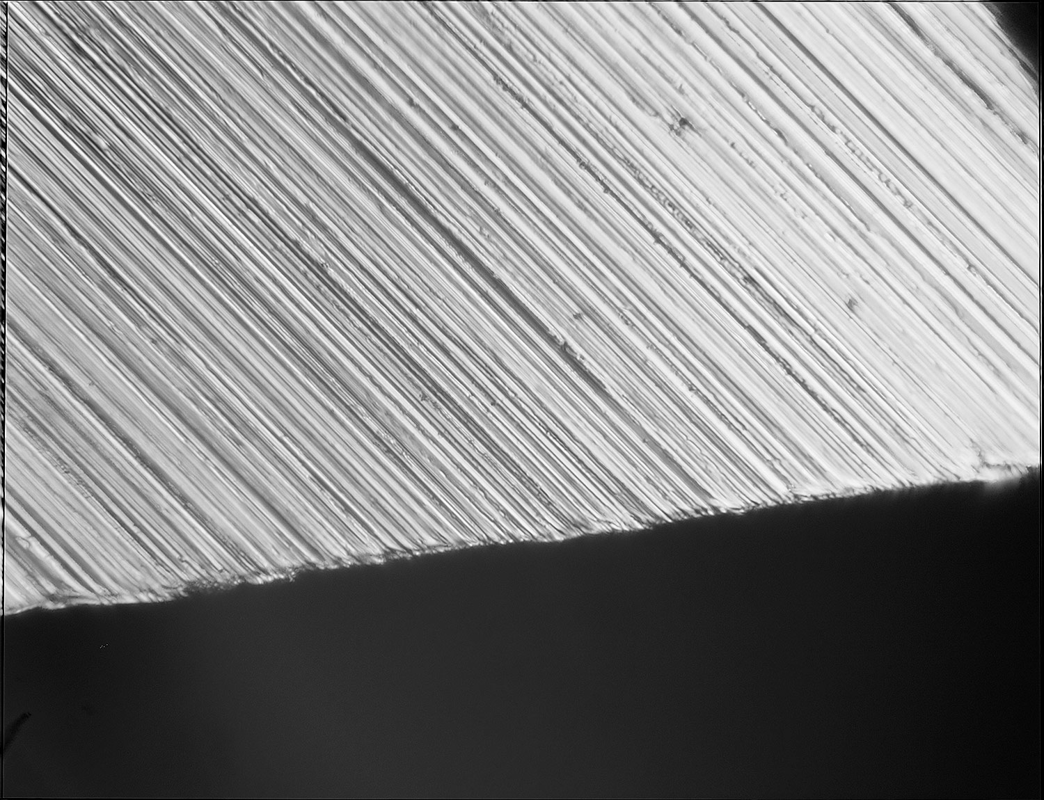

Here are some images of a blade sharpened with a moderately broken in 1500# stone at 2000x:
[attachment file=“1500#—2000x—Shoulder.jpg”]
The image above shows the shoulder and bevel intersection. I polished the shoulder down to .5µ without spending too much time trying to make it perfect. Most of the widest scratches measured between 2.5µ and 3.5µ from ridege to ridge.
[attachment file=“1500#—2000x—Edge-2.jpg”]
This images shows the edge at 2000x. The widest gaps between the teeth also measured between 2.5µ and 3.5µ from ridege to ridge.
Both images are stacked using the microscope softwares EoDF function which saves me a bunch of time from doing it in Photoshop. I only used 3 images for each stack.
Next I’ll use the 9µ on the bevel and image the results. After that, I’ll restore the 1500# scratch pattern and then use the 6µ film.
Looks good! 2.5µ - 3.5µ is about the range I’d expect the scratches to be.
Great pics by the way! That EoDF function works very good.

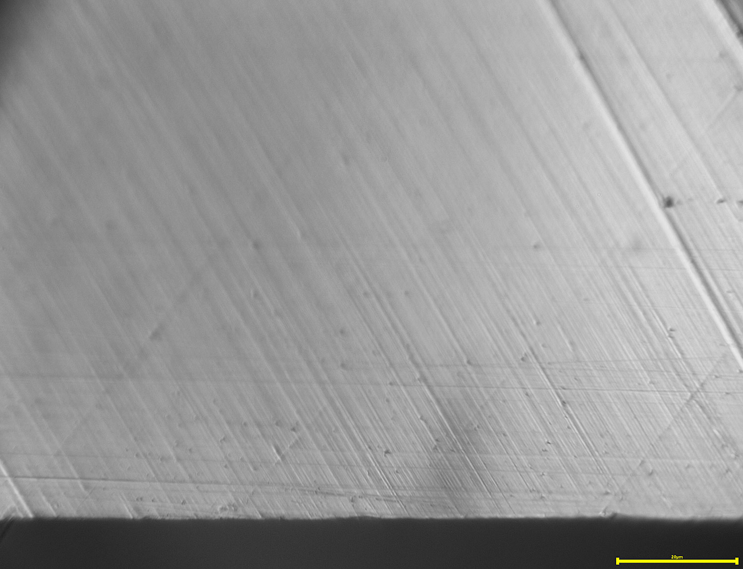

For fun, here is the 3µ film. I did 10 strokes per side in the following progression, switching direction each time: 1500#> 9µ >6µ >3µ:
I didn’t do a great job of cleaning the sample prior to imaging it, but it still gives the idea. The majority of the scratches with this film are between 0.20µ and 0.35µ. There were a couple of outliers at around 0.50µ.

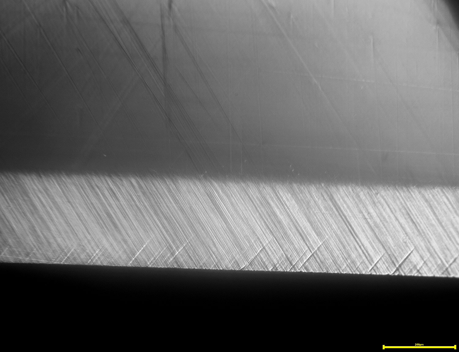

I just reestablished the 1500# bevel with 10 strokes and then jumped straight to a new set of 3µ films. I did 10 strokes per side with the films:
Overall, I think it’s a doable jump though 10 strokes seems too few because there were still some 1500# remaining. So a person could go straight to the 3 micron but would need more strokes to fully clean up the bevels. For that reason, I still think the best progression is 1500#> 6µ> 3µ.
Here’s another look at lower magnification (200x) that shows the leftover scratches from the 1500# stone. It also shows that I didn’t make it all the way to the edge with the 3µ films:
