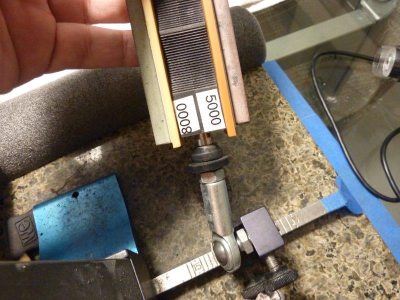

Here’s where I sit, just to try to get an edge on this knife, try to mount it and set the angle.
You can see to set to 16 degrees, one side has to be almost to the end of the micro adjustment and the other has room, it’s a pretty big gap, if you were doing this in person, you’d understand. My thought, with the knife being 90 degrees, if one side needs more adjustment than the other, there’s a cant and you’ll end up with uneven bevels. So, I’m catching the resolution is to add a degree or two and buy add on’s if your knife is too small. Sorry, having a hard time swallowing it.
Couple things. Don’t use the symmetry side to side as an indicator of the knife’s positioning. Not unless you have verfied that the vice, arms, gross and micro-adjustments, side to side when set identically, with the adjustment screw threads backed all-the-way in, give you equal angle readings when measuring a clamped flat, straight piece of metal like a machinist ruler with a zeroed calibrated digital angle cube. I have tried this, others have tried this and I’ve found it to vary some from side to side. The difference was a couple 10th of a degree, not that much, but still there was a variance.
Also, knives are hand ground and hand finished. They are not true and symmetrical side to side, either. Some I’ve found are very close. Others are way off side to side. As a regular part of my sharpening process, I clamp then visually inspect all knives under lighted magnification before sharpening. Seldom do I find a knife right out-of-the-box with even appearing bevels, side to side.
I do lay my machinist ruler against the side of a clamped knife, when possible and check the angles of the flat sides with the zeroed angle cube, side to side when I believe a knife may be misshaped, missground or cockeyed in the clamp.
Unless you’ve taken steps to identify what your working with, both tool and knife, I wouldn’t and couldn’t make any assumptions or draw any conclusions about the source of the variance. There are too many variables.
Lastly, for me, I don’t care what the “L” bracket settings read side to side, and where the micro-adjustment screws are positioned, as long as it visually appears mounted straight and vertical and the bevel angles measured with the zeroed angle cube are the same +or- 0.02º or so. Afterall what maters is how it looks to the naked eye and how it cuts.
I given this some further thought. If you’re still convinced the knife clamps at a cant, I’d reverse and reclamp the knife with the knife point towards you, this time. If it’s a knife issue the cant should reverse with the knife. If it’s a vice issue the reversed knife should still lean left as your initial complaint. You may also want to swap the vice jaws side for side. Just push the pins out and exchange their position and remount. It be interesting to see if that has any influence. I realized they’re a machined part but there is a possibility of a fault in the quality control when machining.
