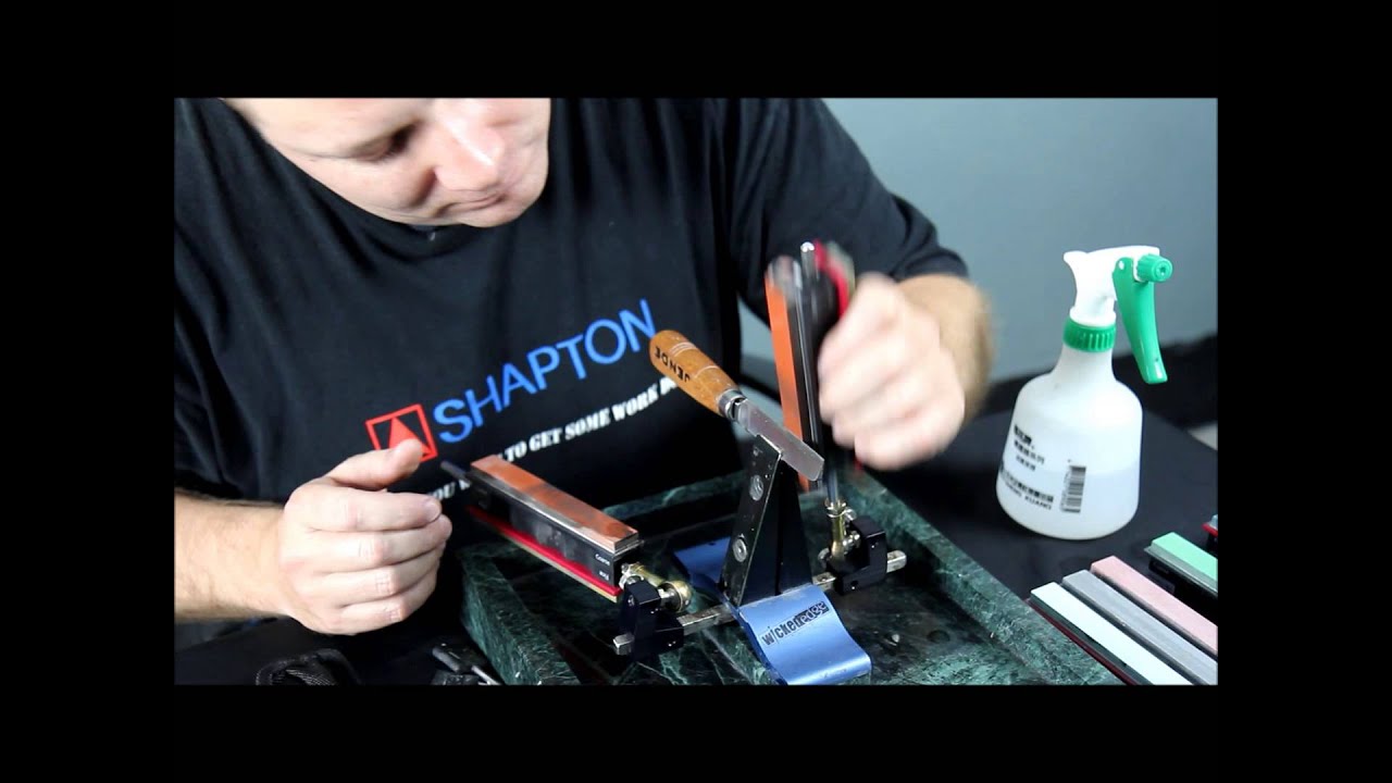

This is all I can offer for those types of knives:

This is what Tom Blodget responded. He produced that video. I just linked him your forum original post.
“ok, so the only real way to get the inside of the scoop is to getthe stone inside. Your’e looking at a rod of sorts with sandpaper or film. The bevel on the rest of the knife should be straight forward. It can get weird if its a scandi grind, the back face of the blade looks to be slightly hollow ground, so that is done flat.”
It’s hard to tell how small diameter the curve is. Maybe DMT diamond rods could be used on the curve.
