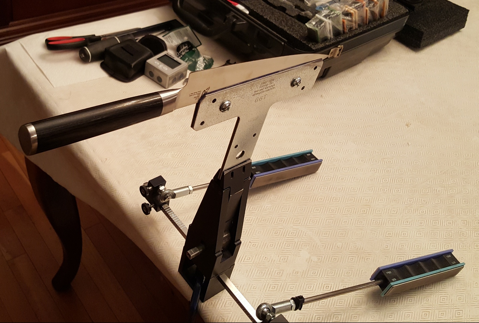

You could try something like the attached. I use it for flexible knives but I’m sure it can open more than 1/4". You probably would want to do a slight bend on the top long edge of both sides to maximize sufficient clamping surface area. It cost me $8.99
There is no question the gen 3 is a nice holder. Personally I prefer the original vise design. It clamps well and will hold anything!
Is that an adapter you made or bought somewhere? If bought, can you please link to it?
Here’s a link to a thread you may find useful.
https://knife.wickededgeusa.com/forums/topic/down-dirty-laa-mod/
That’s awesome, thank you! I’ll be heading to HomeDepot tomorrow to find some parts I can use.
