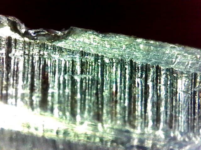

I always try to inspect the bevel with a USB Microscope at 250X before sharpening to see what I’m up against. Here are those bevel shots:
Recurve Bevel before sharpening
This is the flat potion bevel before sharpening
This is the confluence of the two bevel portions

While using the flat diamond stones in the recurve section of the blade, only the side edges or the side corners of the stone make contact with the curved knife edge. I applied very minimal pressure, as suggested by Forum members who I asked for guidance on sharpening this knife before I tackled it. I worked the stones up and down across the length of the curve avoiding working any area for too long, constantly moving back and forth along the curve. I paid particular attention to the blade edge parts at the recaro and convergence point of the two bevel portions.
I did each of the knife portions separately to completion with the 1500 grit diamond. The flat portion was straight forward like any other relatively flat knife. Care was exercised at the tip, as always, so not to round it off. I paid particular attention to the convergence point where the recurve and flat bevels meet. I did with the intention to bring it to a crisp peak and it worked out quit well. There is a distinct visible break where the two bevel shapes meet.

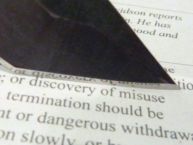

Here is a photo of the flat portion of the bevel
This shows that just using the basic diamond stone progression to 1500 grit and finishing with basic leather strops, (4µ and 2µ) that a mirrored beveled edge is possible, if enough time, effort, patience and technique are applied.
This knife I sharpened for a friend, an EDC. It is sharpened to a practical working edge. I did discover bevel fractures in both portions of the knife during the sharpening and polishing processes. I will bring that to the owners attention. I did not want to remove metal attempting to remove the fracture portions since it may have just destroyed the knife. After-all it’s only a $20 knife. It’s not worth putting that time and effort in it. As sharp as the edge is, now, it may work fine and continue to be useful for years to come.
This discovery is additional proof of the value of using a visual aid tool , the USB Microscope. Without it I’m certain I would never have known this defect was present. Now I can, in good conscience, share this information with the knife’s users with out fear of him getting hurt or blaming me if the knife should fail.
