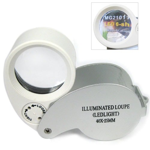

I cannot quite see the mechanism in those 10x loupes, but here’s the picture of the 40x I referenced above.
Below the magnifying glass, you can see the circular battery cap with the words “LOOSE” and “TIGHT” on it. Those two little holes (conveniently, the arrows point at them!) are how you remove the cap. I inserted the tips of a very sharp pair of needlenose pliers into the holes and unscrewed the cap. Weird. It may be that your loupes use a similarly obscure cap setup.
The only real drawback is that the stupid batteries cost more than the loupe itself!
-Pie
