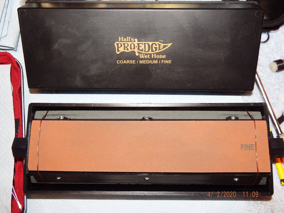

Here’s a photo of my stones, Marc. I’m not sure why you don’t want to talk here but that’s ok. I would still Rockwell test the Japanese steel before I blamed diamond stones.

I’m confused by your characterization of your Buck knife’s steel as " so hard". My understanding is its 440HC SS at HRc 56-58. Which in today’s popular knife steels is just a moderately hard steel. I don’t consider a steel as “hard” until at least HRc 60. But that’s my personal delineation.
Why you had difficulty sharpening it with the Pro Edge Tri Stone, I have no idea. I can only suggest, all whetstones are not the same. Some are better for harder steels others not so good.
FYI: There are many blogs describing carbide breakout and other steel damage experienced using diamond sharpening stones. What I experienced and share is not a very rare situation. https://scienceofsharp.com/ and http://knifesteelnerds.com/ are a couple of these.
I know and that is what I thought about Buck steel. I never had a problem with any other pocketknife with my whetstones(maybe these should be called Oilstones). I think the steel in my Buck 301 somehow was hardened more than they normally are. But I don’t have a Rockwell tester to test it with.
