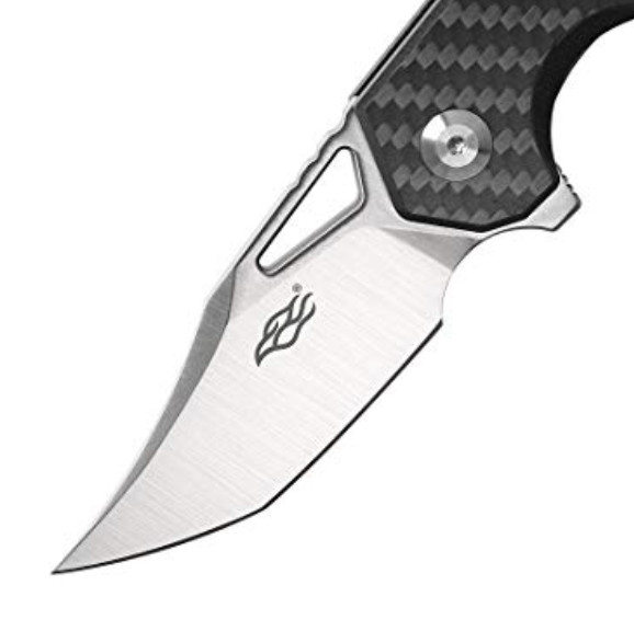

I just got this Ganzo FH61 and I’m wondering just how I’m going to sharpen it. I’m not real concerned about maintaining the exact apex of the “curve” of the belly, so I’m thinking about just mounting it up like it had a rounded belly. My strokes will follow the edge like usual, which may end up rounding over that belly apex.
Thoughts?
That’s a nice looking knife, especially at an inexpensive price point. The combination of these different edge profiles and angles adds to the interesting quality of this EDC knife. IMO, to ignore the edge break and round it over as if it was a long continuous belly takes away from the character, interest and function of this knife.
Without holding it is my hands and physically trying to clamp this knife myself, I can only guess and suggest that I would try to clamp it in a manner that would allow me to sharpen the heel most blade portion alone, as a single blade. Then I’d reclamp the knife, if necessary, treating the tip or tanto-similar portion again as if it was a separate knife. This would hopefully allow me to maintain and accentuate this edge profile break.
The large incorporated recasso or sharpening choil should eliminate sharpening difficulties at the edge’s heel portion. As for where and how I’d clamp this knife with it’s squared spine integral thumb hole, without having it, holding it, and trying it, it’s difficult to exactly say. On a first attempt, I’d try to clamp it across the flattened spine portion around the integral thumb hole. The upper blade sides just below the spine would be my second choice clamp position to try.
Thanks for the help. You’re right as usual and I should do everything I can to maintain that blade shape. Actually, my normal procedure is to sharpen in sections anyways, so that might work to this blade’s advantage. As you said, clamping will be a concern, as there are a lot of surfaces there. It really is a beautiful D2 blade and at a price that will reduce some of the anxiety I will have with my first strokes.
My sharpening advice here is the same as I would share with you.
I go with the principle of keeping the factory blade shape.
I would try to clamp the blade with the vise on the “thumbhole” area, with the “belly” of the forward section mounted high and relatively horizontal, with the straight heel section at about 30 degrees on a rising slope. From here, you can work both sections independently. Take care to not round over the point of convergence between the two section.
Good advice. I def going to attempt to keep that factory edge shape. I guess that’s what attracted me to the knife in the first place, so you’re both right…I should keep it. Thanks.

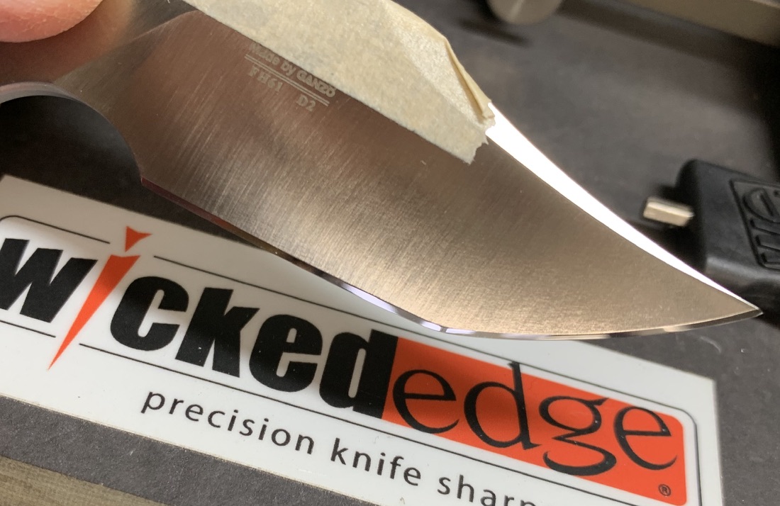

Of course, I couldn’t leave well enough alone and sharpened the Firebird knife over the weekend. I tried to use the mounting position I proposed above, but found that it’d only work if I disassembled the knife. The thick G10 scales get in the way of stoning the heels section.
So I did it in two sections: one with the heel section mounted horizontally (normal position) and secondly, with the blade tilted so that the forward section was horizontal. The factory angles were pretty variable, suggesting that it was the work of a hand-operated sharpening station. Generally though, I’d say it was about 18 dps, so that’s what I went with.
I started at 800-grit and went through 1000, 1500, 2200, 3000, then 6, 3 and 1.5 micron DLF. The micro photos below were taken I think at 3000 grit.
Each section was stoned using a great deal of care not to roll the stones around the corner apex, as I wanted to retain the double-edge look. It worked out very well and the edge at the corner apex being every bit as sharp as the rest of the edge(s).
I didn’t take the time to set up my light box or to change to my close-up lenses, the the full-size photo is less than impressive.
IMG_0709
Here’s a micro of the corner. The opposite side is almost exactly like this view:
Ganzo4 cropped
The point of the exercise was to demonstrate how the factory edge could be retained. That having been proven, the knife is now substantially sharper than “as delivered.” And downright scary. Mostly because of the compact nature of the beast. If you have a secure grip on the knife when you open it, your fingers are going to be wrapped around the scales, and therefor exposed to a lot of very sharp points and edges. You not only must be aware of the knife’s two edges, but you must also be aware of the clipped-point tip, which is sharp enough and shaped so that it can bite you both ways.
