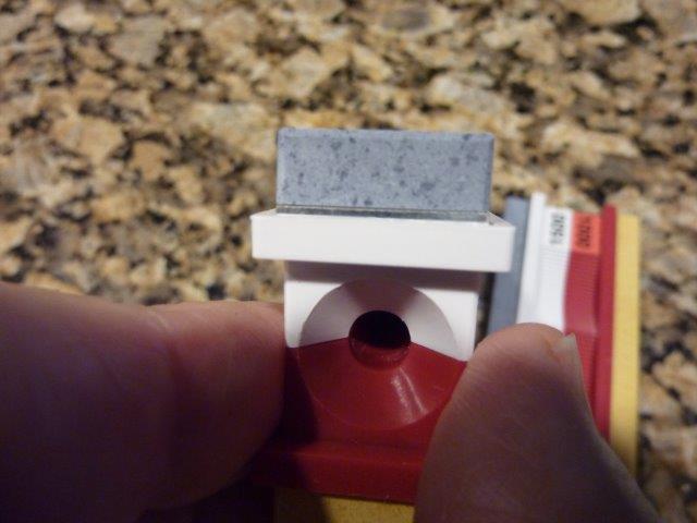

Sean, another option maybe to use Whetstones to sharpen knives with that issue. Due to height and shape of the stone they stand up above the plastic lip on the W.E. paddle. The whetstone profile, height and shape would allow you to get in closer to that tight shape transition between the blade and the choil. I believe these will work for you without the need to permanently alter the blade or the stone plastic handle.
Here are photos of tall new whetstones:
