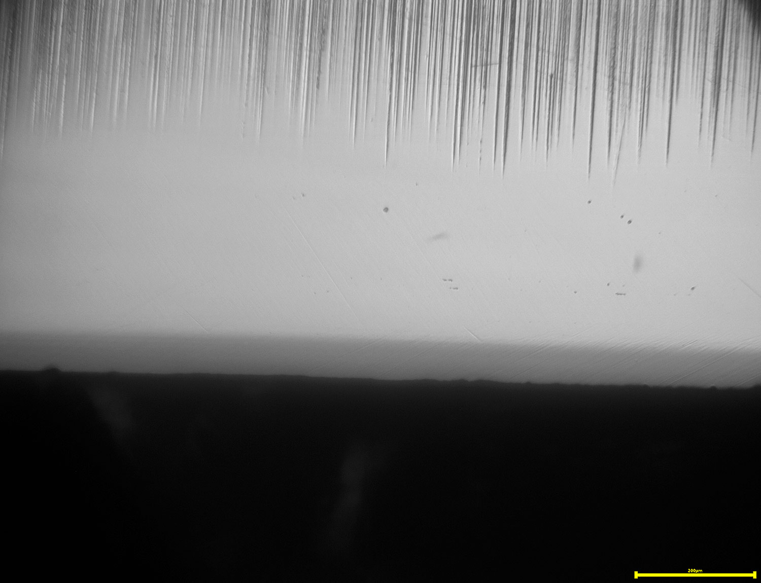

I just happened to be playing with a ceramic knife from Kyocera last week and got to shave. It’s not amazing yet, but definitely sharp and shaving. I used the 800# then 1000# then 1500# diamond stones and then went to 9, 6, 3, 1 and .5 diamond films. I found that it’s crucial to approach the blade gently with the stones to not “slap” it as mentioned above. I’ve also found in the past that keeping the stones and films clean by routinely dipping them in water really helps because the ceramic turns to fine powder as it’s abraded away and loads up the stones and films quickly. Here’s a pic at 200x showing the edge:

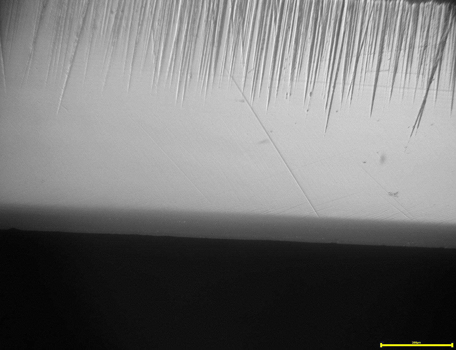

I got curious and started playing around some more. What I found was that when using the coarser grits, I had the best success with strokes completely parallel to the edge so I rested the bottoms of my handles on the ball joints and just moved the stones back and forth along the blade. Doing that prevented any chipping. So I reprofiled the blade from 20 dps to 15 dps with that technique and took it all the way to .5 microns with the diamond lapping films. The edge looked great, no chips or anything but it didn’t shave. So I established a micro-bevel at 20 dps with the .5 micron films using strokes more perpendicular to the edge. It resulted in a little chipping but also made the knife easily shaving sharp rather quickly. Next I’ll mount up some .1 micron films and see what that does. In the meantime, here are images at 200x and 2000x:
You can see that there is some chipping though the chips are pretty small.

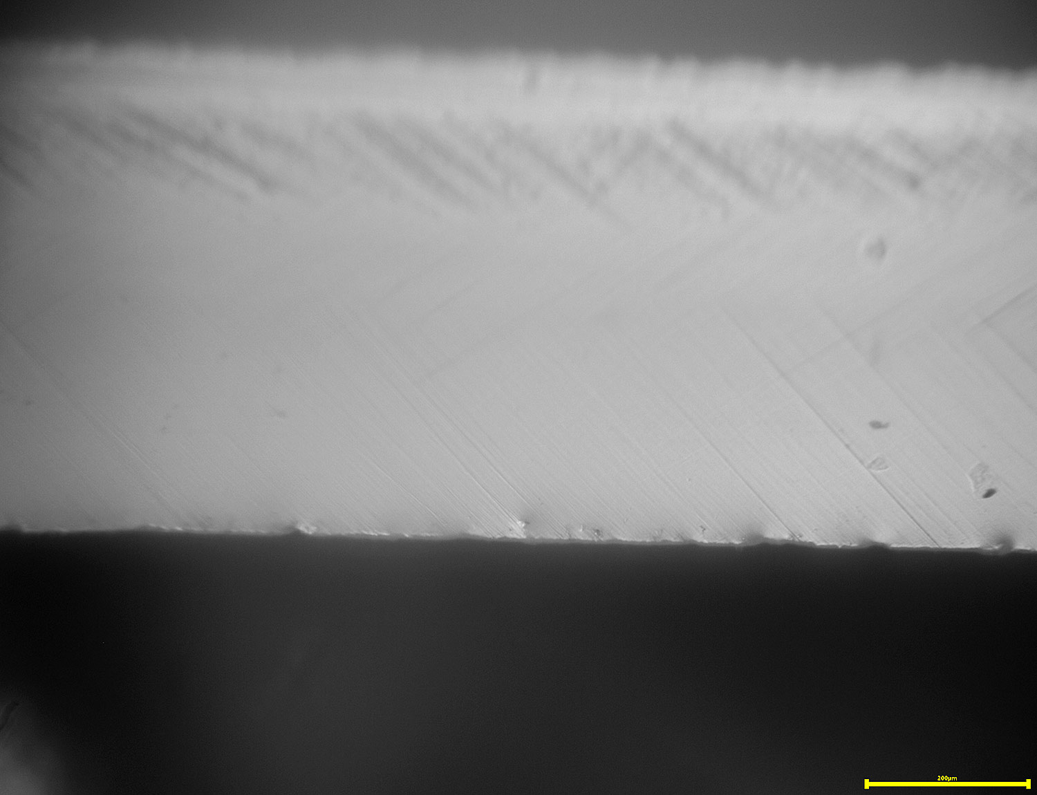

Moving to 0.1 microns made a nice improvement:
The knife is shaving much more smoothly now as well as looking better under magnification.
