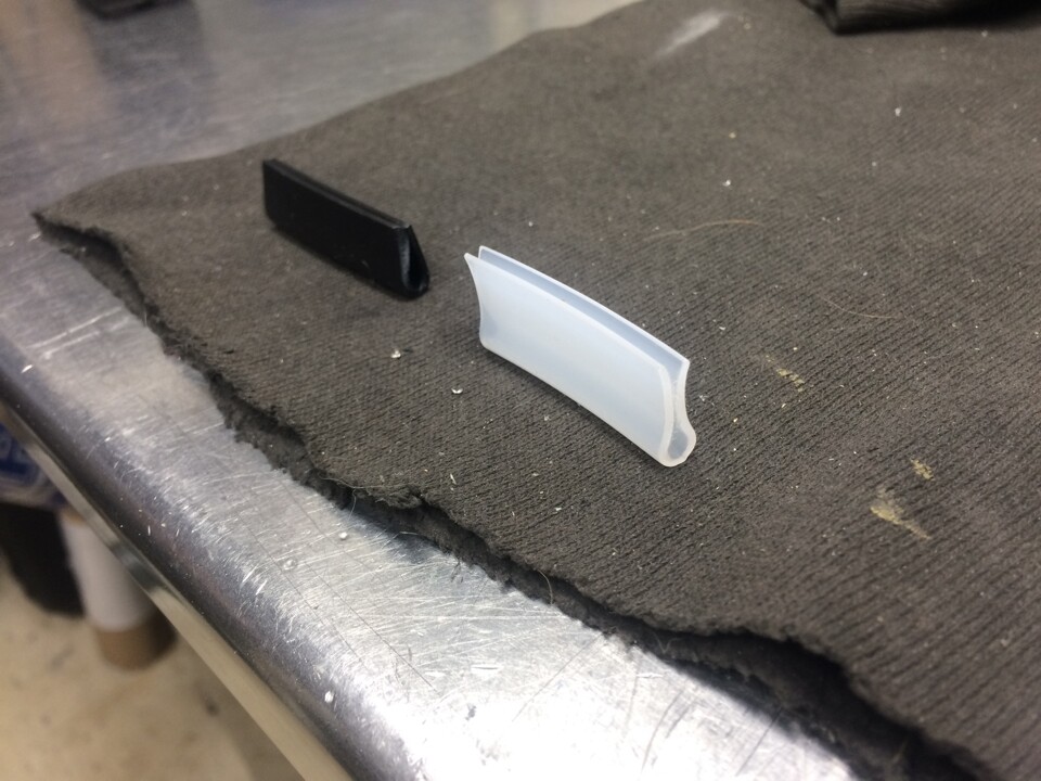

I had the same issues and found a product made by CapPlugs that works great for me. It’s call Edge Guard and used mainly for protecting the edges of sheet metal (from people getting cut). The part number I used was EGL22-4. I bought it through McMaster Carr, their part number is 86875K46. The cost is $ .70 per ft. under 100 ft 0r $ .54 per ft. over 100 ft. Myself, I bought 100 foot and put it on every knife I sharpen for piece of mind for both blade and people protection. I have no association with McMaster Carr other than a happy customer. They are not the cheapest outfit in town, but they do have hard to find items (like the edge guard).
Note there are two different types of edge guard in one photo. The white one is the edge guard I mentioned above. The black also works, but is harder to get on the blade therefore I do not recommend that style.
