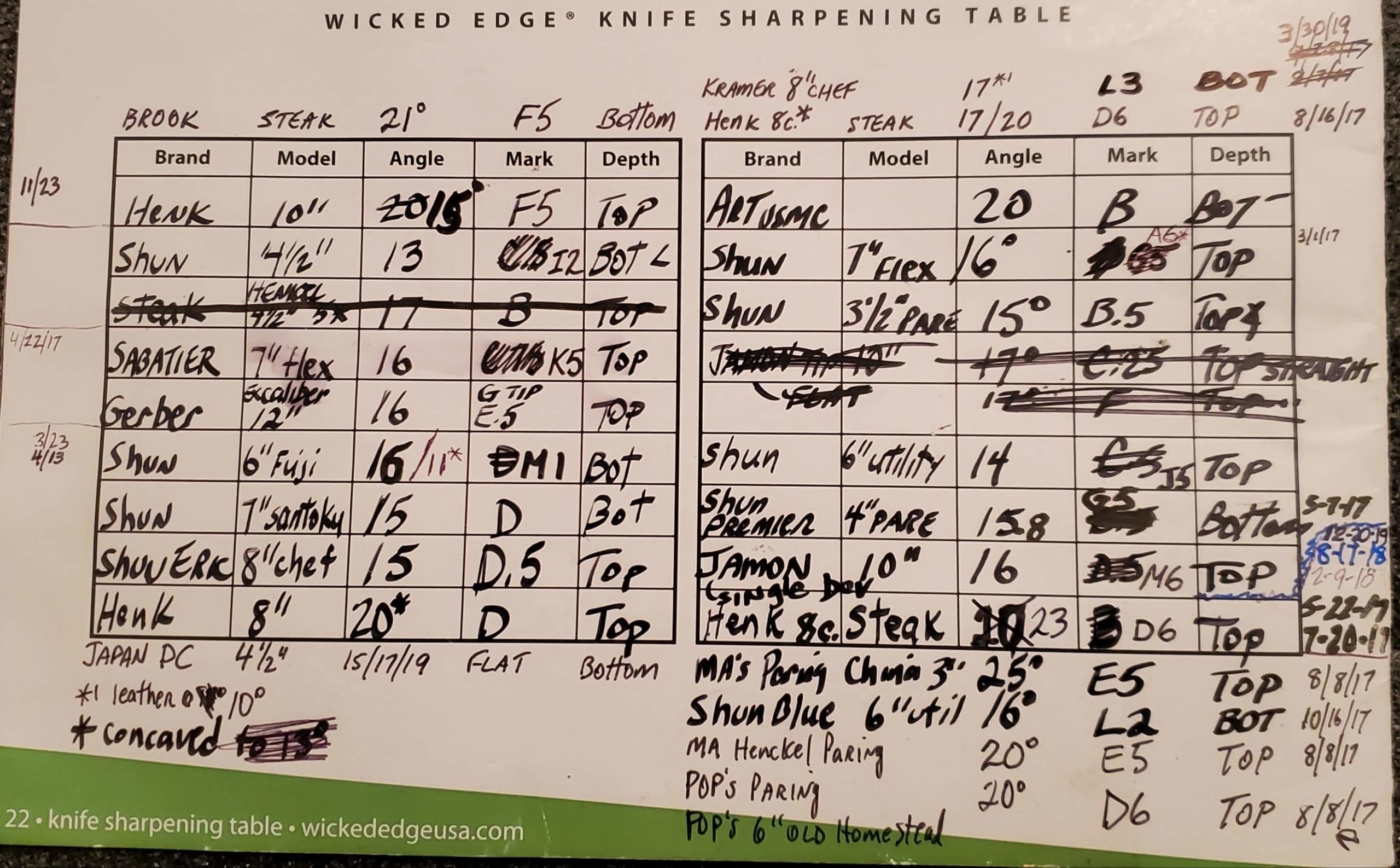

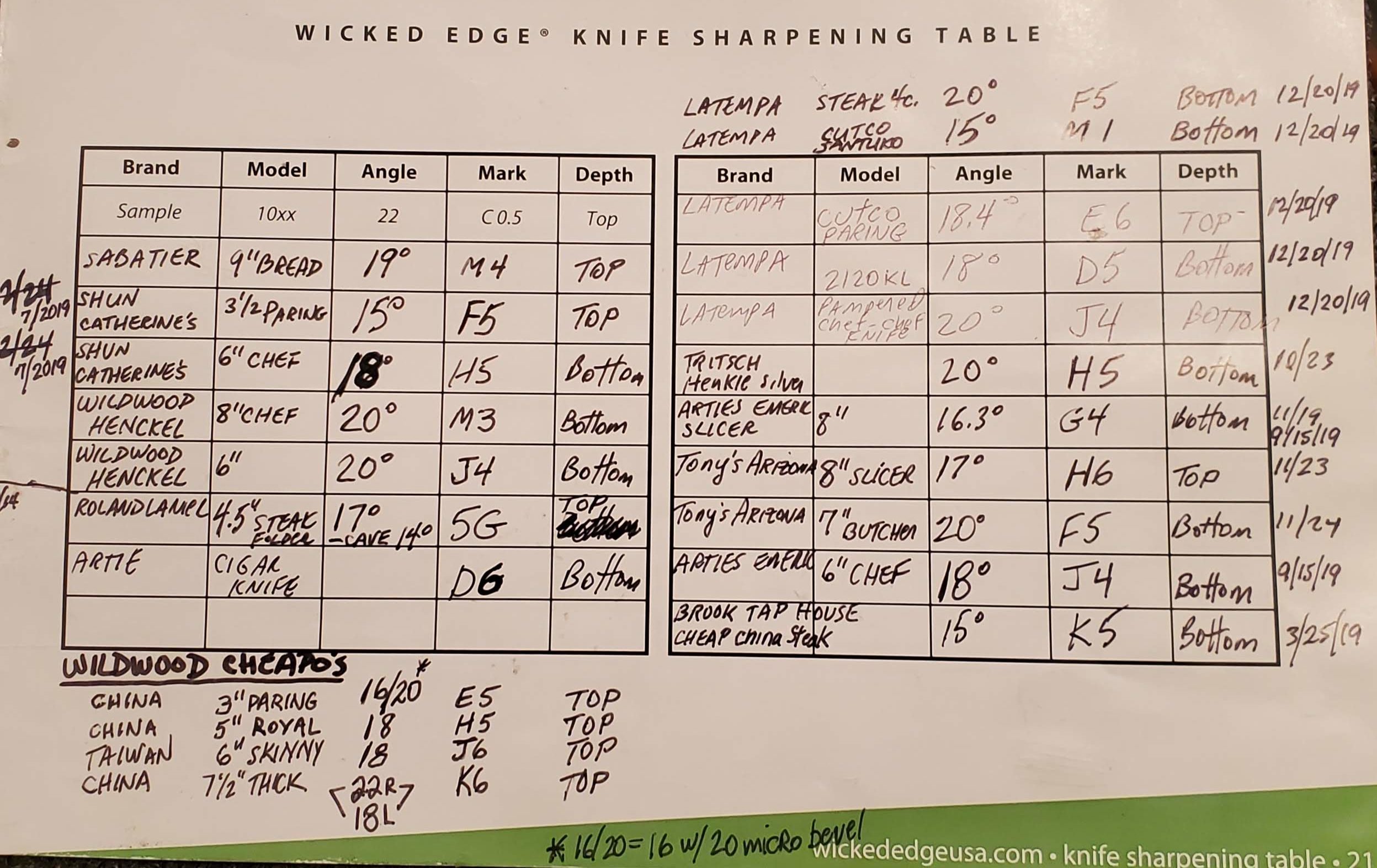

As an aside, attached is my ~3 year old log. I’ve done about 30 different kitchen-only knives and rarely use the sharpie/scope unless it’s a knife I have never seen before. Although scope is great for small chip verification. The log gets me close to where I need to establish a full burr (absolutely needed).

Thanks for your comments Reedheads. And your chart pics too. I’ve kept a log from day one of my first knife. Thats the beauty of the WE system is its repeat ability. I luv that about it. I’m just trying to save sharpening time when freshening up my edges. I’m trying to avoid dropping back to the 800’s just to freshen an edge. The two “Ceramic” steels I purchased are god sends for freshening an edge up between sharpening. It only takes a couple of swipes on each side of the knife. I use the black one on my folders as the steel on those are harder than my kitchen knives.
I’m interested to see if Organics slight micro adjustment suggestion can reach some of the spots on the apex that still have black marker traces, so I don’t have to bring excess metal to get a burr across the entire edge. I’ve been having to repositioning the knife which to me goes against what my original re-profile chart position and angle was. I especially seem to have issues with the tip area. Re-reading Marc’s sticky on finding the sweet spot helped me with that.

I am impressed with your methodical note keeping. I started the log when I got my first WE100 2016 but got lazy and started to use my phone to take pictures. Since I only do 5 or 6 knives on a repetitive basis this works for me.

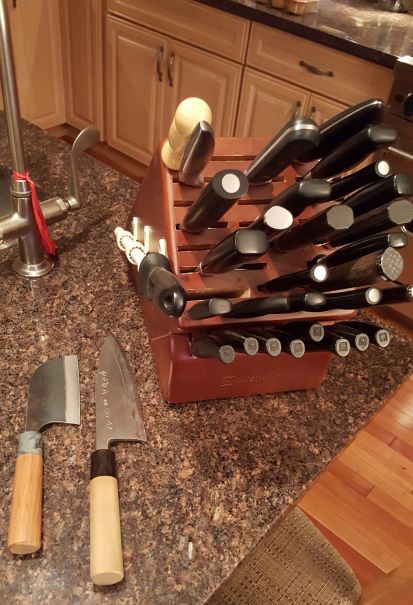

Like “Readhead’s” knife block full illustrates, I have another sharp knife I can use to avoid forcing me to reprofile my knives, that have been touched-up with other devices. I employ, as those gentlemen do, a detailed and complete sharpening log and utilize my alignment and/or advanced alignment guides, that, with experience, now allows me to position the knives for touch-ups just like I had originally clamped, profiled and sharpened them. The W.E. touch-ups are quick and easy, matching my original edges with very little effort. That’s the beauty of this sharpener, it allows repeated precision, accuracy and sharp edges. That’s why I try to only use the W.E. With a collection of knives there really is no reason not to.
