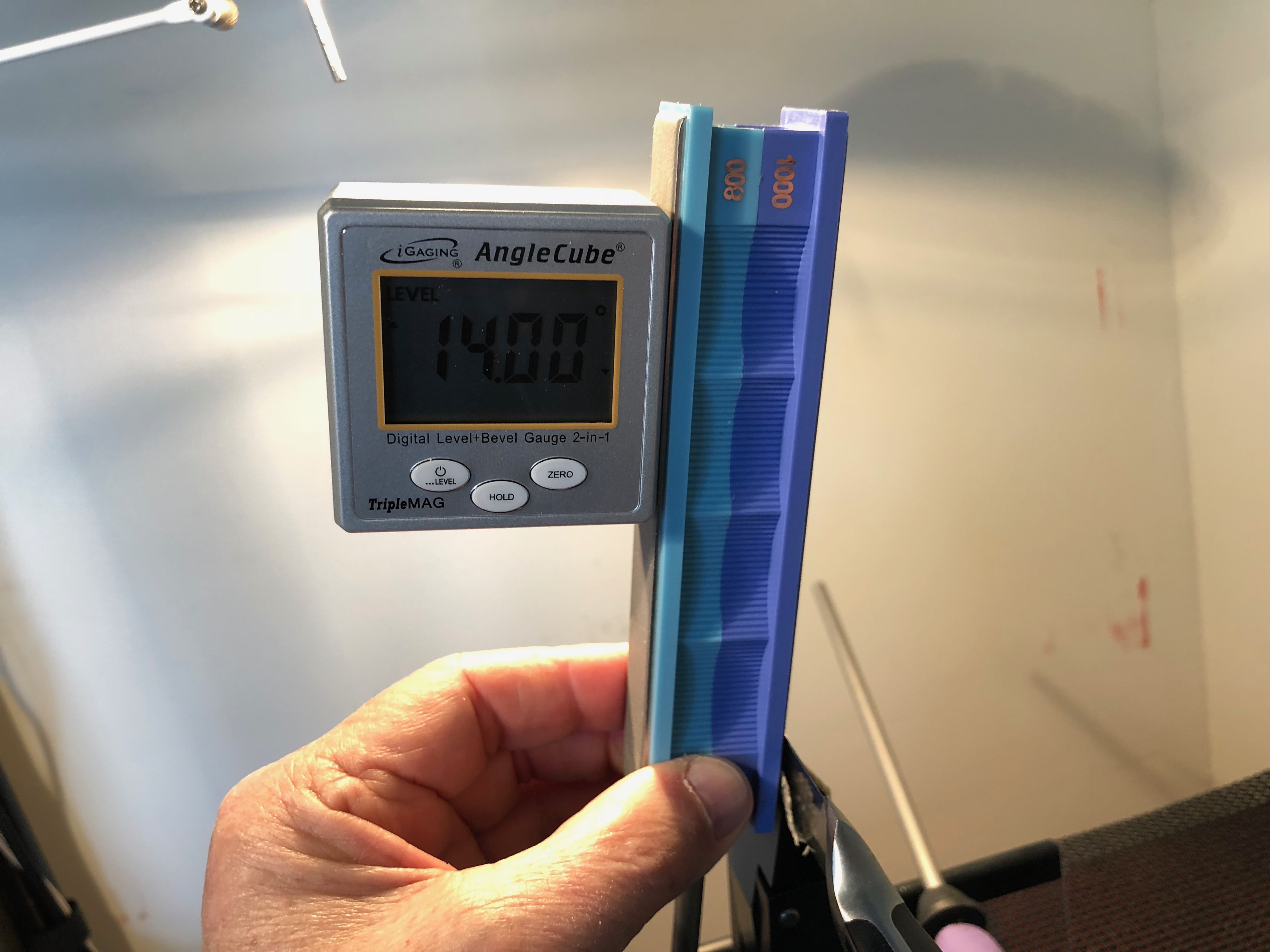

UPS rang my bell a few minutes ago and delivered the angle cube. I set the knife back up on low angle adapter to double check what angle i had sharpened it at figuring I screwed up by not adjusting the angle for the added height of the low angle adapter.
I think I was right about screwing up because I zeroed the angle cube on the base and then put it onto the a 1000 grit stone and it was reading 9.50 with the WE 300 angle indicator on 14.
I had to move the indicator all the way back to a reading of 20 degrees in order for the angle cube to read 14. Am I on the right track to have to keep it on 20 degrees to get an angle of 14 with this thin small blade. My 1500 grit stone also came today so I went back over this knife for awhile with the angle cube reading it 14 degrees.

The angle marks on the wicked edge are calibrated for blades that sit something like 5/8 inches above the clamp (I always forget, so don’t quote me on that). The markings will be inaccurate for all other situations. This is why the angle cube is essential if you want to know what angle you are actually sharpening at.
Just because a manufacturer says their blades are sharpened at a particular angle does not mean that they are actually sharpened at that angle in reality. Most people have no way of checking these claims and have bought into the marketing hype that more acute angles are better. Acute angles can be good for kitchen knives and knives intended for delicate work, but you might find that a more obtuse angle holds up better over time especially on knives intended for harder use cases. It can be interesting to try different angles on the same knife just to see what geometry works best for that knife.
The only thing I use the WE angle bar increments for is to indicate I’m going wider angle or narrower angle when I move the rod ends. I always use a zeroed digital angle cube to determine the relative angle. The WE angles scribes, like Organic stated are just a rough guide. This angle indicator is based on a particular size knife mounted in a particular configuration. These angle scribes should not be used to profile a knife when a precise relative angle is wanted. Always use the zeroed digital angle cube when in that situation.
I too have found the same situation Organic has seen that factory specified bevels don’t usually relate to real world measurements. The only knife I ever sharpened that matched the printed factory specified bevel is a “Shun” knife at 16 degrees bevel angle per side. Expidia your experience is the same as I had and many others before and after me. It’s a good lesson you’ll never forget. Now you have it you’ll never sharpen without the angle cube.
You said “large Wusthof” I take it that it’s a chefs knife and if so the angle you sharpened at would be 16 or 17 deg. approx. if the bar was set at 19 deg.
Yes, im sure you are correct on that angle being the knife is big and mounted high even on the lower holes. Now that I have my angle cube, I’ll do it again but first check some of the other larger knives in the wusthof set to check their factory bevels. Their website says they are ground at 19 degrees, but as others have already said rarely in the real world do the factory edges match what a company says their angles are cut at.

Just to be clear on my understanding. You wrote the factory spec is 14º per side. Did you actually clamp the knife in the Low Angle Adapter so the stone does not hit the vice, apply the sharpie and determine the actual bevel angle? If so what was that measured angle when the stone removed the sharpie directly on the factory bevel?
I prefer to read the digital cube when it is more centered and even with the bevel. That is when the gauge is even with the knife edge and the stone is placed with an equal amount of it’s length above and below the knife edge. It probably doesn’t make a big different but you have the gauge held way high above the knife edge. I suggest you find a method and placement to do your angle reading that you will utilize the same positioning consistently every time you take the angle measurement while sharpening that knife. Consistency is key when using the Wicked Edge.
Yes on the clamping of the knife and measuring the angle which read 14 degrees (which even the slide level on the angle selector was at 14 degrees for this style knife). The stone touching the jaw was very close, so I moved the stone up a little higher to measure the angle so it would not hit and that was the picture of the angle cube reading. It was the same 14 degrees when I measured lower and just ahead of the jaw. This was the setting that removed all the marker on the bevel.
