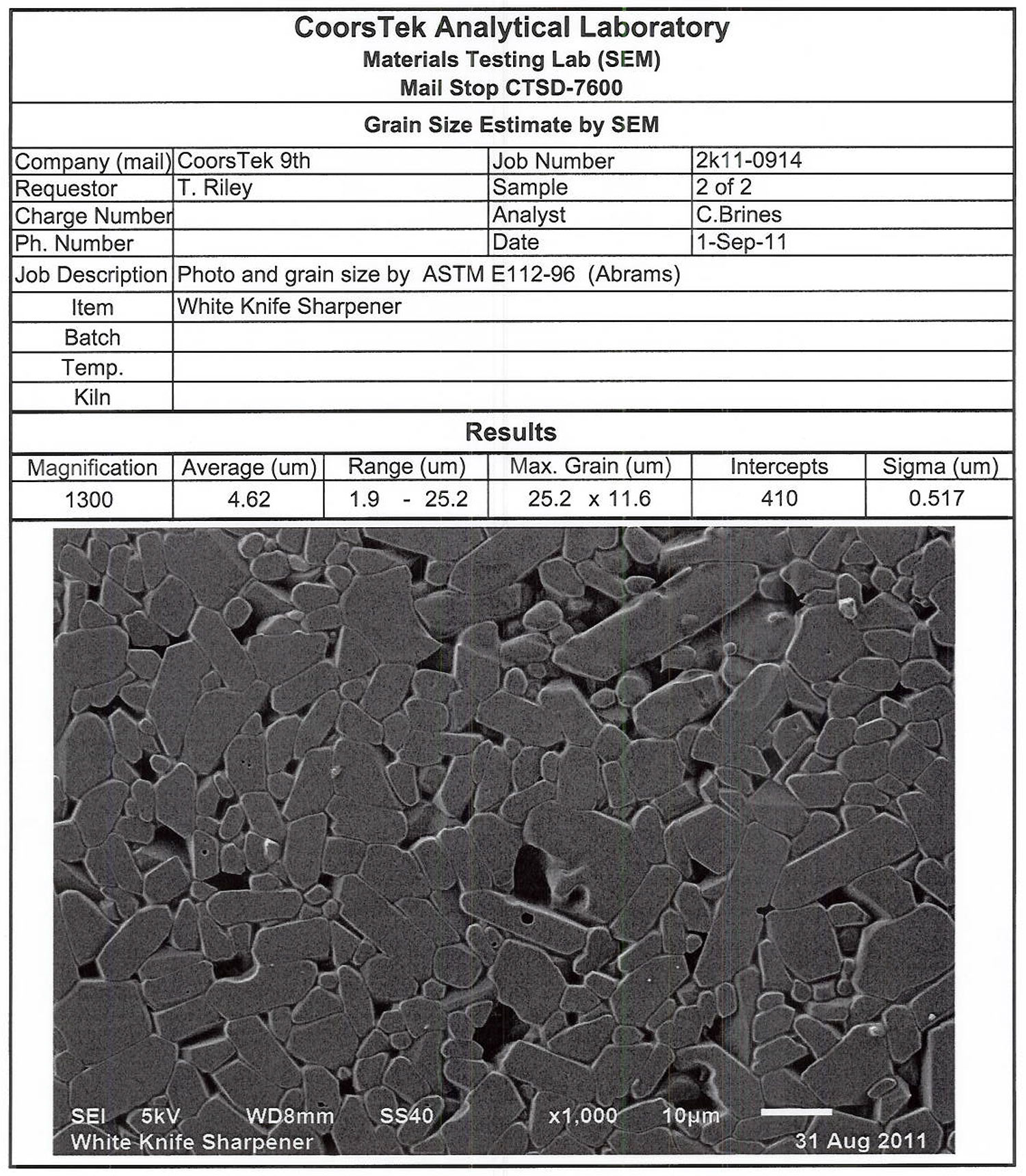

I’m not sure Sal will even be able to answer that. The stones that Spyderco uses are made by Coorstek, the same manufacturer that makes our Micro-Fine stones. I dug up the SEM photos that Coorstek sent me when we first got started after I badgered them for a while about the grit. They originally gave me grit sizes of 1.4µ for the brown stones and 0.6µ for the white stones. I asked for more detailed information, which is when they sent me these images and explained that because the grain sizes vary so much as a result of the sintering process (they’re essentially melting and forming new structures), they prefer to grade the stones by Roughness Average (RA). They also explained that the surface texture can be changed and tuned through lapping and that the new texture creates a new RA for the stone, which will last a fairly long time before the peaks are eventually worn flat again. You’ll see that the grain size is a lot larger than the stated grit size:
I’ll look around for data sheets on each stone.
These stones are the reason I want to come up with a new grit chart that evaluates the scratches left by a given abrasive rather than just grading the particle size. There are too many variables for particle size alone to accurately describe what an abrasive will do to your knife. In addition to the RA for the ceramic stones, there is the hardness and porosity of the substrate with strops, the friability of the abrasive particle in synthetic whetstones and crystalline structure of diamonds and other abrasives both in stones and lapping configurations.

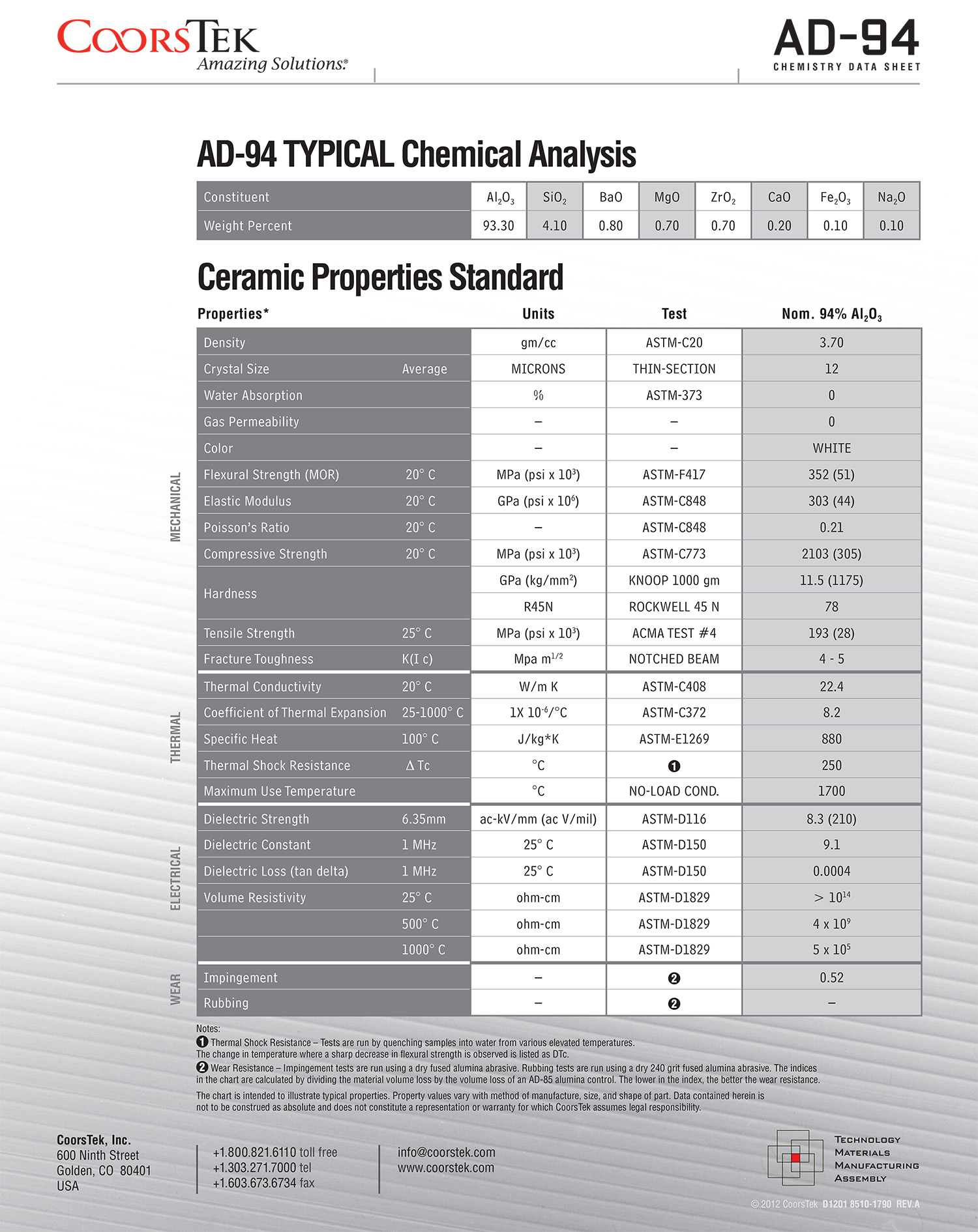

Here’s the data sheet on the white, Micro-Fine Fine stone:
It’s interesting that the original crystal size averages 12µ but the structures vary from 2.4µ to as large as 44.8µ. It’s also interesting that the stones are made up of Aluminum Oxide, Silicon Dioxide, Calcium Oxide, Ferrous Oxide, Sodium Oxide and have some Zirconium Oxide in them.
