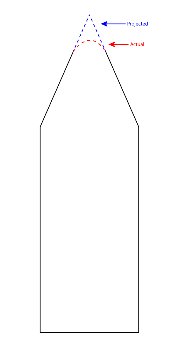

The way I interpret Todd’s definition in a practical sense is this:
You can have a very keen edge, measured by the width at the very apex (point where the two bevels intersect) but have a larger included angle. In this instance, the blade is keen but not necessarily sharp enough to cut whatever it is you’re trying to cut. If you thinned the bevel behind the edge to a lower included angle, then the edge would be both keen and sharp.
I visualize the bevels as two non-parallel planes, or surfaces. If they can be shaped such that they meet at a point, producing a keen edge or apex, which is simply the intersection of those planes. If, for some reason, the planes don’t actually intersect and the actual edge lies somewhere below the projected intersection point, the edge will be wider and will not be very keen. That scenario can happen on a blade that has a lower included angle and is somewhat sharp for certain tasks but would not be able to perform the HHT. Conversely, you can have a blade that is keen but too wide behind the edge to pass the HHT. The apex would be small enough to get in between the cuticle scales but would be too thick behind the edge to complete the cut. The width of the shoulders would start to distribute the force applied by the blade to areas adjacent the actually cut and would cause the hair to bend away instead of being cut.

But what I did not understand was how two bevels that were keen could not cut well. But implicitly I assumed the bevels intersected, i.e. met at a point. If the middle of the edge lies somewhere between the projected intersection point of the bevels, the edge can still have a small angle, but not be very sharp. I had not imagined that scenario.
But how could you get that scenario? If you sharpen your knives well, the bevels always meet, don’t they? Or am I overseeing something?
Isn’t that what we experience as we use a knife and the apex wears, the geometry hasn’t changed it just doesn’t intersect as closely, precisely …keenly?
MarcH is right that wear will produce this result. Another way it can happen is by incomplete bevel formation because you didn’t sharpen your knives well. To the naked eye, the bevels might look like they meet but actually fall short of intersecting at a point, which is why it’s important to use magnification when forming your bevels, especially if you’re trying to do it without creating a burr at some stage. The image below explains it better.
Thanks guys! That explains it completely. And it has improved my English .
One reason the explanation Clay gave did not come up in my is that I always make sure to get a burr, and then gradually remove it (with finer grits and sometime stropping), so that the bevels always meet.
