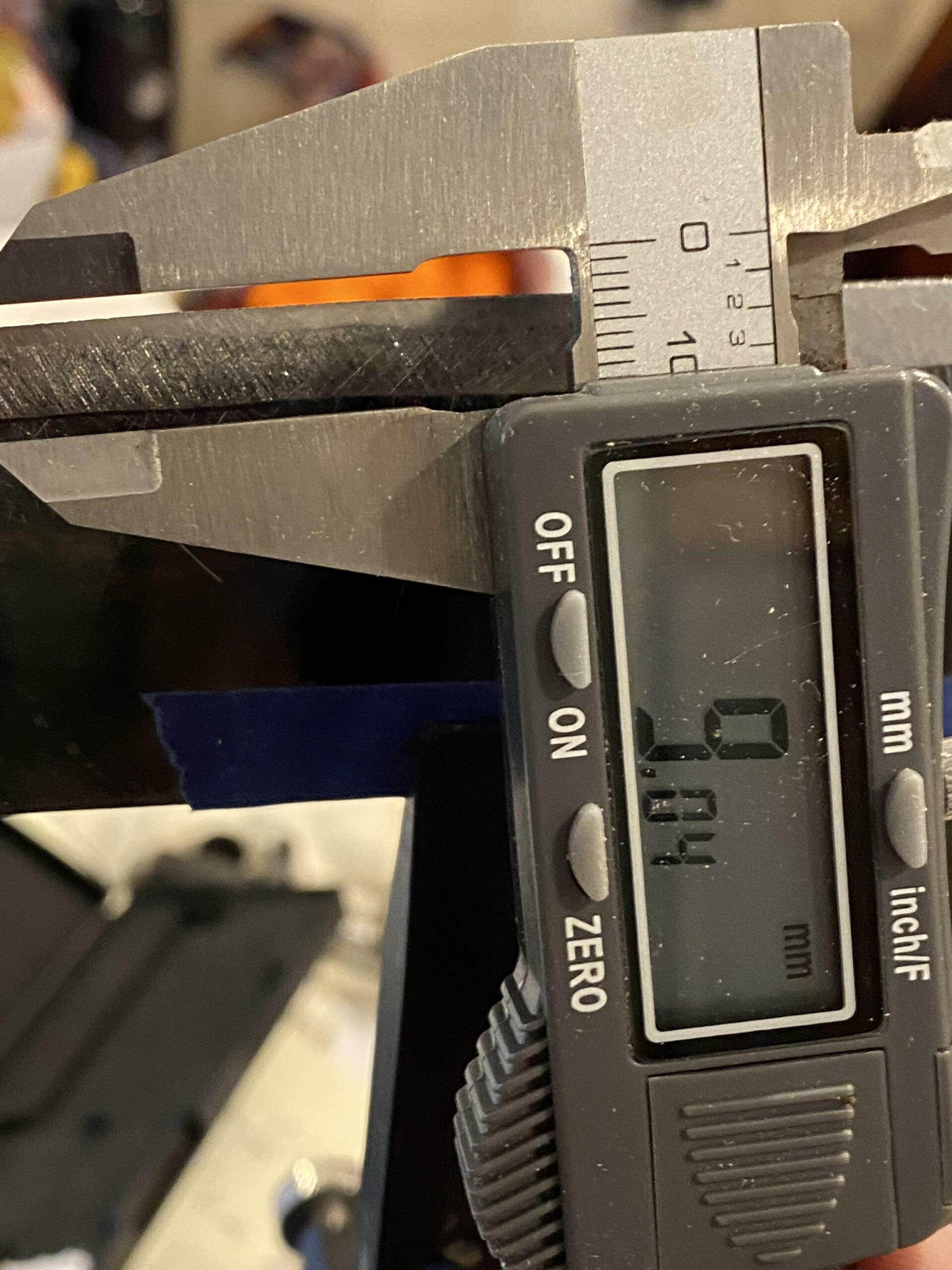

I’m attaching a single pic taken from a cell phone as the shenogi is too wide to readily demonstrate the observations on a scope. Please note that this is a knife still in the sharpening stage and the edge needs a lot more work. The plan is to make it shine, eventually, and NOT ever put on a micro bevel. But, I’m pausing the sharpening as I investigate the second shenogi or what could be called a second bevel (which is NOT the desired effect).

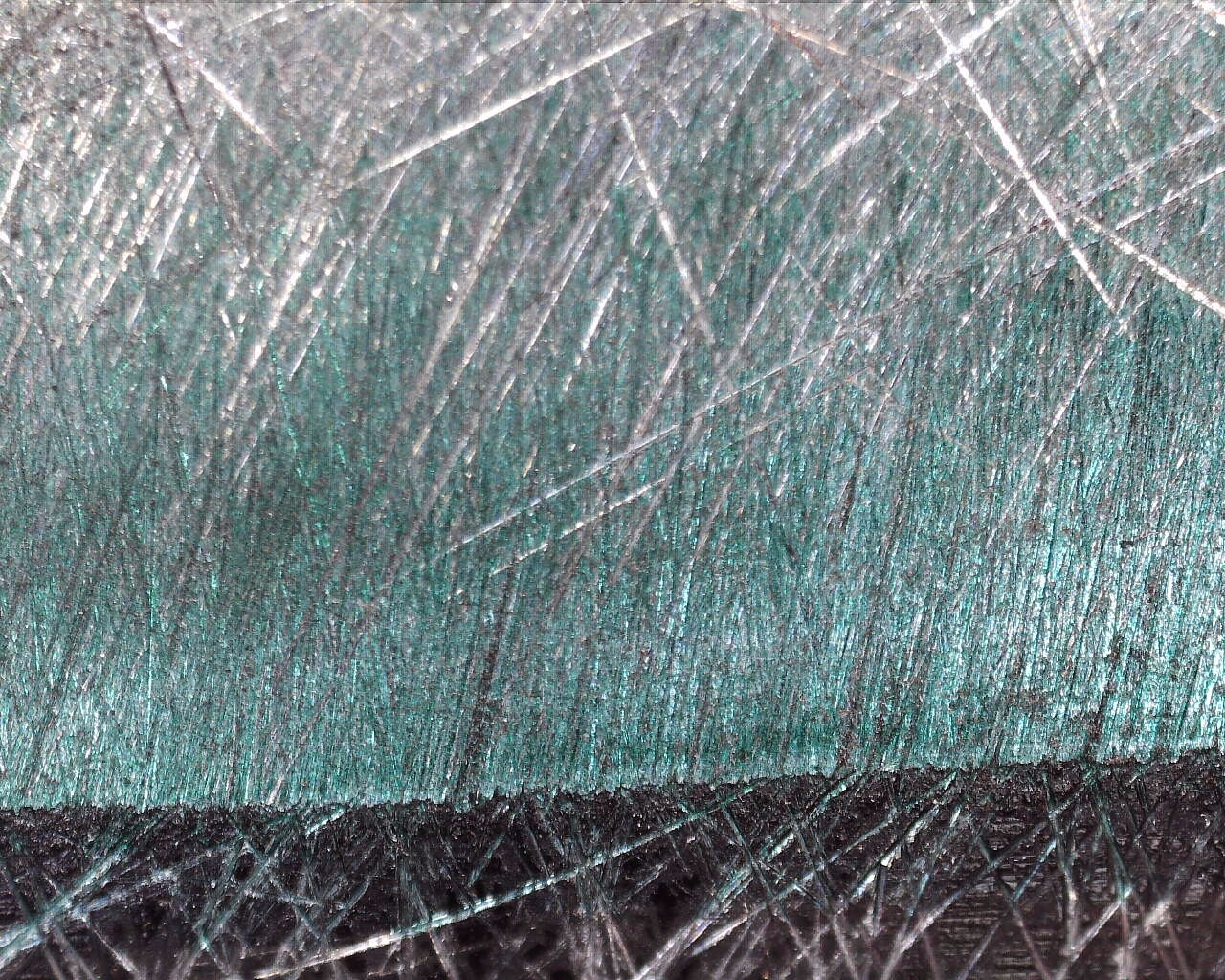

Here are a few photos:
  1. Forget the file names of "5 minutes" (it's from a starting time 20 + minutes into 100 grit scrubbing. Note the Apex is still missed, but what the photos do not show is the edge easily slices paper. The phots clearly shows I've removed metal on the top 1/3 of the shenogi.
![Ishikawa-Bunker-chasing-the-Apex-200-grit-same-stone-as-100-before-note-taking-off-closer-to-apex-not-shoulder-12-27-21-1.jpg](upload://5rlwCmZ1iFqpeKeTT3dSfGpjtCu.jpeg) 2. These show the same moment in time but the rest of the blade (will not fit, even on low power, into a single photo. One is of the bottom of the shenogi and the other is at the top (kind of a duplicate of the above pic, but I'm trying to "blend" the 2 together.
Note now the green “fades” in on the bottom 1/3.
I guess the only thing to do is micro-adjust the 200 side of the paddle to remove all green.
I’m still not at the Apex as observed by the green on the blade edge. I must assume it’s sharp from prior sharpening with the micro-bevel???
To be continued. I may just drop the angle of the 200 by an ever slight amount and 200 out the green. This will eventually leave me with a nice shiny shenogi and if I repeat this process it may eventually create a semi-convex shenogi (albeit ever so slight). I’m tired of scrubbing chasing that last 1/25’th (guess) of a mm of the apex and just may live with needing a concaving or micro-bevel at this time. It’ll create a future nightmare or at least a lot more thought and work to flat-sharpen if I do so. Or, I suck it up, back down to the 100 and scrub away till the apex is finally reached on the last 1 1/2’ of blade that currently apparently still has some micro-bevel left on it.
The reason for this post, consistent with the subject line, is it seems that even within the same paddle, both sides appear to be at enough height differences from the inside bore (on that side) of the paddle to make enough of a difference to show when sharpening a knife with a quite wide shenogi.
To be continued I’m pretty sure.

Henry, your post #57396 above, with all the close-up USB photos makes it hard to figure out your issue. As forum participant 000Robert has previously posted multiple times, “a picture is worth a thousand words”. If you could include a wide-view photo of the entire knife clamped in your Gen 3 Pro it would be very helpful. Your sharing the issues you’re dealing with, with lot of words. Without us being able to see or understand the actual sharpening situation is difficult to comprehend. We can’t help you fix what we can’t see or understand. All that you’re sharing are closeups of random scratches. That doesn’t really show us anything. Please help us put it in context.
Hi Mark et Al.
unfortunately the setup is put away so I can’t take a cell phone shot. And yea… the pix are too close up to make sense of this without my secret decoder ring interpreting my writing; as I wrote:
  1. These show the same moment in time but the rest of the blade (will not fit, even on low power, into a single photo. One is of the bottom of the shenogi and the other is at the top (kind of a duplicate of the above pic, but I’m trying to “blend” the 2 together.
So basically I’m showing the top and bottom 1/2 of the shenogi, at the same place on the blade, demonstrating how on the same setting, same paddle, opposite abrasive side, I’m seeing a different sharpening angle. I’m only scrubbing the top ( edge) portion of the shenogi and missing the bottom 1/2 completely when switched the paddle over to the 200 grit side.
This demonstrates that each paddle side has a different enough thickness or distance from inside face of the bore to the outside of the abrasive ti affect the sharpening angle.
I ultimately used the micro-adjust on most paddle sides to dial in the same angle and called it a day.

Geometrically, a 14 degree angle producing a 9 mm wide bevel suggests that the blade is about 2 mm thick, given that this is a single bevel knife. I once put a single bevel on a cleaver and the resulting bevel was quite a bit wider than 9 mm.
