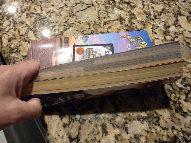

Fancy that…someone just left me another free book of “Sharpness Test Media” at my front door:
