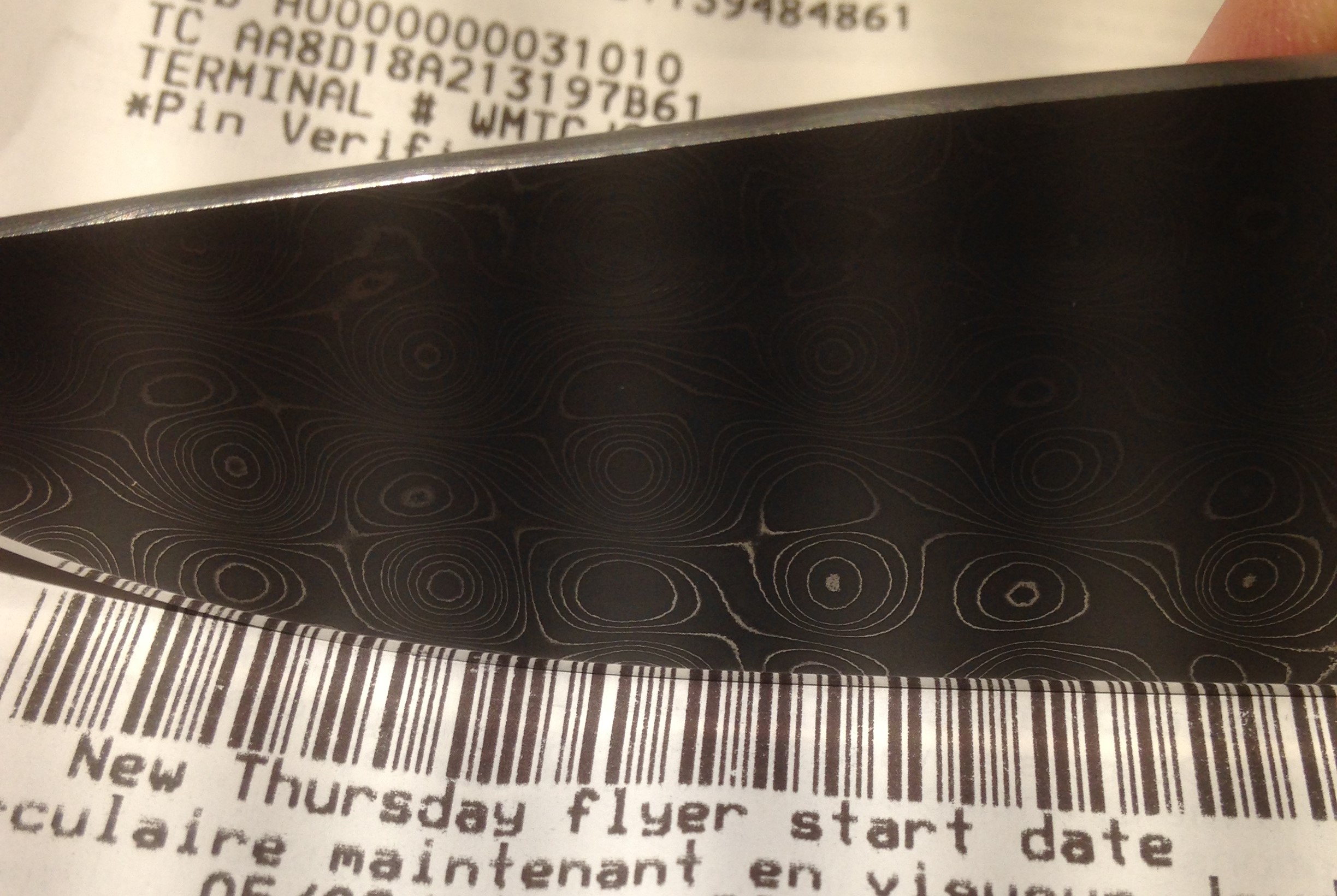

On the results side, I have tons of trouble with the vise. I don’t want to scratch my knives when clamping them, so I put a piece of aluminum tape on the spine and flat or primary bevel, depending on the knife, then a coat of blue painters tape. I snug the top screw up, and tighten the bottom one, most times if I just gently push the handle of the knife, it will come right out of the vice. Like spin towards me and fall right out. with the edge now facing me. If I tighten it more, the blade starts to tilt off the vertical axis. Then I need to take it out and do it all again. Once I finally get it secure sometimes it’s not in the sweet spot anymore. So it’s a lot of pissing around. Sometimes 15 minutes to get it into final stable position. Then sometimes when I check on it mid sharpen, it’s off axis from vertical again. Sometimes as much as half a degree.
So I can get down to a pretty good mirror polish, but I can’t get them hair whittling sharp. Shaving sharp easily, but not to the point of being able to pass the hanging hair test or similar.
Here are some pics:
The above edge was achieved by hand. I was too frustrated to monkey with the WEPS due to long setup time, and worried about damaging the Damascus… and had a new leather strop to break in so figured no risk to the rare Damascus and need to work a strop so why not. Also was comfy with a slight convex edge on it.
This one is my latest go on the WEPS, good polish but not particularly sharp compared to the one done by hand. Easily shaves arm hair, but won’t cut hanging hair.
