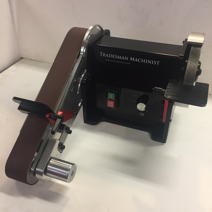

An interesting option for grinding really messed up edges prior to going on WEPS. It has a really quiet DC variable speed motor from 400 RPM to 4000 RPM. I called them and you can get the base unit (without the 2 diamond wheels) plus the belt sander attachment for ~$1,200. I would then get a set of buffer/leather wheels for the other side. Small place innovating like Clay’s shop.
https://cuttermasters.com/product-category/tool-grinders/
Seems like an awfully expensive, awfully sophisticated, awfully nice, fine piece of equipment just to clean up a “bad” chippy profile??
I have more than that invested in my WEPS. And if I want to do major reprofile/repair on a blade it takes forever on WEPS and will wear out my diamond handles faster. This machine can also handle serrated knives using the techniques of the “Patron of Saint of Knives”: https://www.youtube.com/watch?v=zPy84c_ie0g
I plan on having a few different wheels on the grinder side also for taking out scratches, polishing and thinning knives. This is all for kitchen knives. I know plenty of folks who would love to have their kitchen knives returned to as new condition. This machine is whisper-like quiet and can run at less that 500 rpm. It is also a high end constructed unit which other brands cost 2-3X more. I would love to use it also in my amateur wood shop.
Not trying to do a sell job but after looking at lots of possibilities I though I would share. To me its about increased capability and speed especially if I am going to try this out as a PT retirement job.
