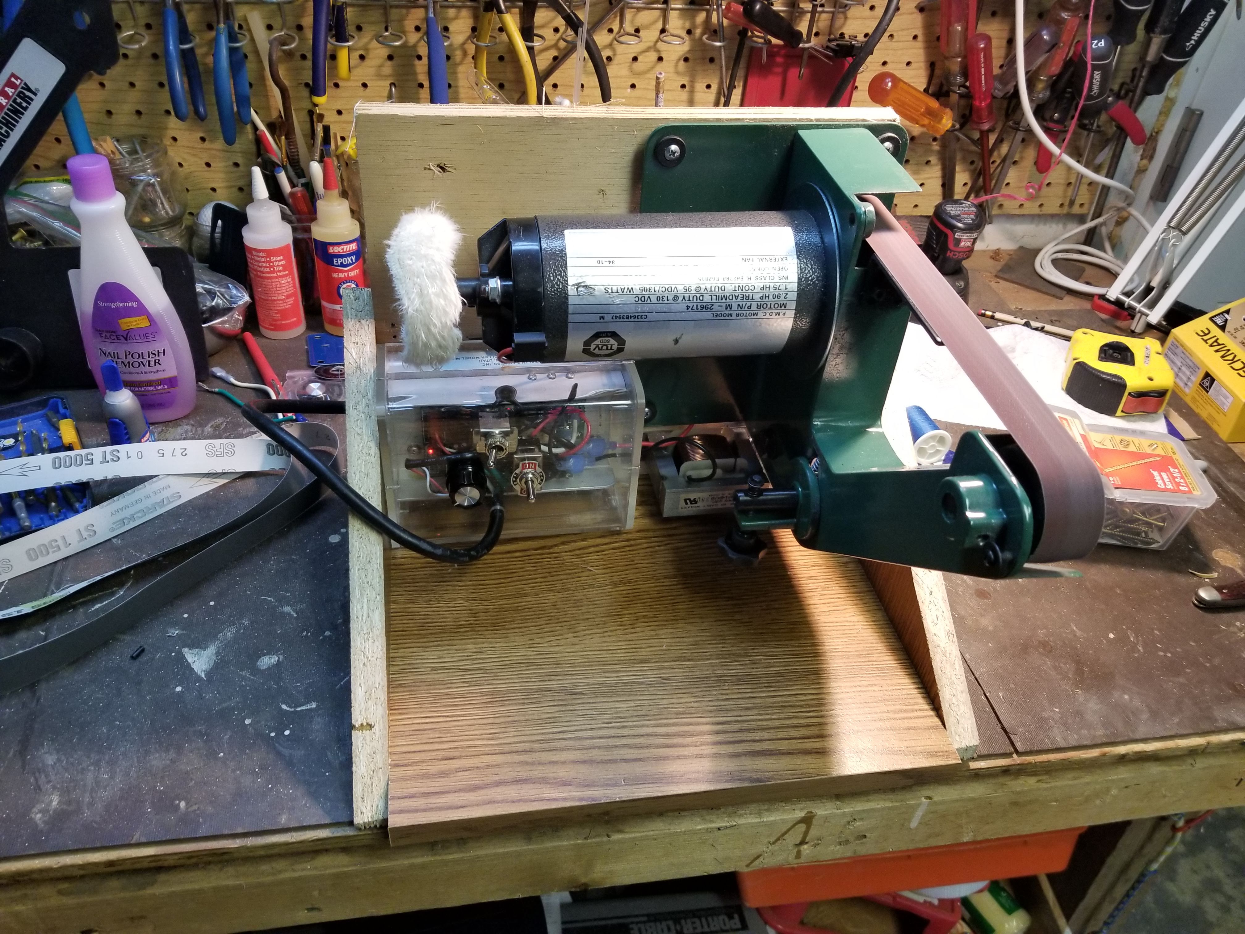

I had the same need for a reasonably cheap grinder to fix chips, tips, bolsters, thinning, polishing, etc before going to WEPS for fine tune edging. I wanted flexibility and variable speed. Viel and the like started at $300 & up (way up). That wasn’t for me as a garage once in a while sharpener. If I was trying to make $$, then I understand investment.
So after a bunch of Google help, I found a $75 solution, it takes a HF 1×30, throw out the motor and get yourself a treadmill motor (DC, variable speed, reversible, high torque/low speed). Pretty much every other house in America has one and most are not used. Plenty of people give them away and the motor +electronics (important) are easy to rip out. It takes some reasonably straight forward wiring, mounting, redrilling, etc but is very doable.
You end up with a 1×30, DC, variable speed, reversible, vertical or horizontal setup for $75. I’ve even used it to remove serrations. As a bonus, there is a second output shaft for a buffer.

Check out Cliff Curry’s Youtube videos. He’s done a ton of mods for a bunch of HF 1X30’s he has. He’s CurryCustomCutlery here on the forum as well as on Youtube as Curry Custom Cutlery.

Well got my threadmill and have it apart enough to see I have what I need. Once I get the motor and electronics ripped out and functional on the bench I guess it will be time go buy a HF belt sander. Felt bad ripping apart a functional treadmill but it was not being used so at least part of it will be used! Scrap guys will get something for the rest of it..
Must be older than RedHeads as everything seems bigger in the electronics end.. but beggars can’t be choosers..
Back to the motor search, this one was just a bit too big for the HF. In the mean time I 3d Modeled the drive wheel of the HF since the original was molded and not very well round. Not sure how it will hold up as it is ABS and more slippery than the molded wheel. Could not stall it with 1" bar stock and a good bit of pressure, so should be great for what I want to do. There is still some runout will put a DI on the shaft to see if it is shaft or wheel. At least if I do find a TM motor, it will be very simple to change the shaft size in the model and reprint. If anyone needs a rounder wheel for their machine let me know.
New Wheel running

Like airscapes, I sometimes embark on projects more for the journey than the destination.
Yup, I have no knives sitting in need of sharpening, so leaning how to model this wheel was useful to me. Learning about the motor in a treadmill and how it is controlled and wired is interesting to me. My first career from 1984-95 was an automotive repair tech (mechanic) so I like to rip apart things, fix things and fabricate things.. Personally prefer modification and improvement of things most of all. Yes, I almost just bought the quality machine but needed something to occupy my mind and hands, so went for the Frankenstein method. :slight_smile:
