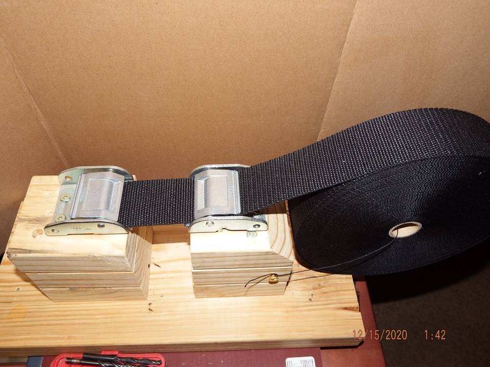

The Bess tester just takes practice time to get used to it. And you have to be careful. But it is not needed really. I decided to keep mine though. If an edge can whittle hairs, it sounds pretty good to me. I have more confidence in my homemade strap holder that I use for my HD 2" Poly and Nylon webbing straps. If a blade edge can cut the strap and stay sharp, then it’s pretty good to me. And the strap will remove burrs also.
